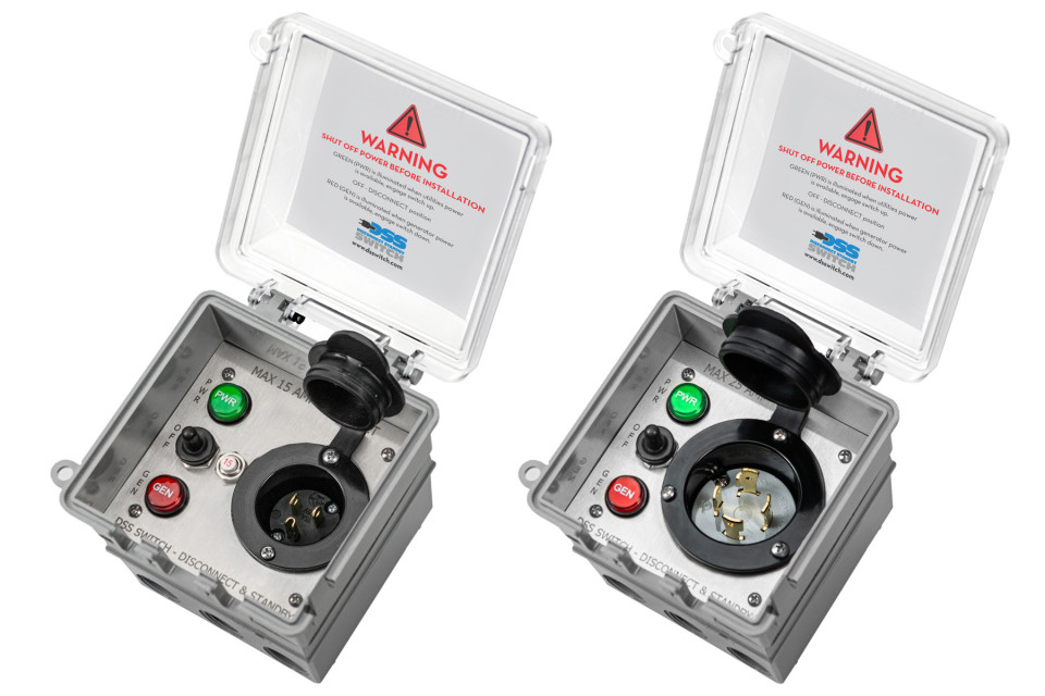

The DSS differs from common condenser electrical disconnect boxes, because it features a three-position toggle that switches from–“PWR” (house power), “OFF” (disconnect mode), and “GEN” (generator position). It’s wired the same as a conventional disconnect box, but uses a plug-and-play whip. If a power outage or brownout occurs, condenser power can resume within seconds by connecting a working generator’s extension cord to the DSS’s grounded three-wire male 120V receptacle (four-wire on 240V models) and activating the standby switch. No rewiring is required.
Assembled in the USA with UL-listed components, the DSS was developed specifically for air conditioners/heat pumps. It’s constructed of a 6 x 6 x 6-inch (152 x 152 x 152-mm) aluminum, corrosion-resistant, NEMA-rated weatherproof box (when in use). The transparent plastic, code-compliant locking cover allows sightlines to the interior power status LED red (generator) and green (house power) lights. It’s available in three voltage/amperages: 1) DSS15–15 amp/120V; 2) DSS25–25 amp/240V; and DSS30–30 amp/240V.
