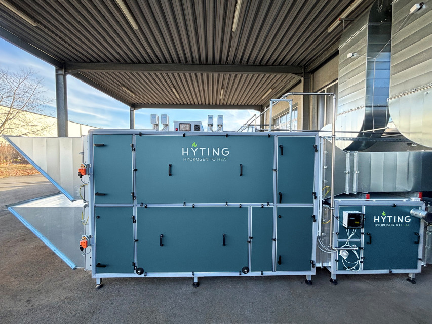

Hydrogen heating technology company HYTING has commissioned its second customer installation, deploying two air-heating units delivering a combined heat output of 80 kW (2 x 40 kW) at a production facility in Markkleeberg, in the German state of Saxony. This represents a significant step forward in the company’s commercial rollout, with capacity eight times higher than in HYTING's first installation. It also marks the customer debut of HYTING’s 50 kW heat generator platform, which features a 10:1 turndown ratio for continuous modulated heat output.
The facility in Markkleeberg is shared by two companies: BURO GmbH, which uses it to manufacture sheet-metal components on laser cutting and punching systems, and Südmetall Schließsysteme GmbH, which assembles electronic locking systems. Each of the two HYTING air-heating units serves one of these production areas, enabling tailored temperature distribution throughout the building.
The system operates in a hybrid configuration alongside a heat pump. The heat pump manages the base heating load, while HYTING's units cover peak demand during periods of high heat requirement or low ambient temperatures. This strategy significantly reduces grid connection capacity and demand charges – in this case by 70% – and enables smaller sizing of the heat pump, reducing both capital expenditure and operating costs, as the heat pump runs continuously at its optimal operating point. Customers can reduce operating costs from day one and achieve a return on investment within approximately three years.

HYTING's technology is based on a proprietary flameless catalytic process in which hydrogen reacts with oxygen from ambient air to generate heat. There are no CO2, NOx, or particulate emissions – the only by-product is water vapour. The technology does not use flammable concentrations of hydrogen at any operating point, making it inherently safe. Its compact, modular design means units can be combined to meet higher heating demands, and the technology is suitable for both new installations and retrofits.
