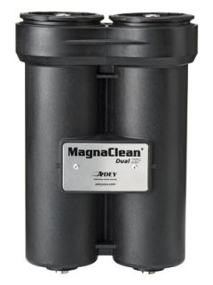

MagnaClean DualXP is part of ADEY’s proven line of filters in Europe, and was introduced to the North American market last fall. This dual-chambered magnetic filter features two magnetic rods that capture and eliminate nearly all of the suspended iron oxide sludge circulating in a system within minutes of installation. The double chambers also house four non-magnetic capture zones for larger circulating debris.
Designed for 1½-inch copper and NPT iron pipework, MagnaClean DualXP is ideal for large residential and light commercial (e.g., churches, offices, small retail) applications. It can be easily fitted on the return pipe to the boiler/circulator, and features low-profile drain valves and built-in air vents for easier servicing. The unit also incorporates a three-in-one multi-tool, designed to remove the drain valve, air vent and lid assembly. It fits into the lid of the unit when not in use.
The ingenious design of the filter works as water is forced in a cyclonic flow around the magnet by the shape and location of the inlet and outlet, meaning there are no moving parts — other than the water itself. Installation of the filter does not block or restrict flow, and pressure drop is minimal.

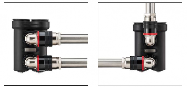

- Rotating filter connections allow customizable installation options

Two of the many installation options made possible by the use of MagnaClean's rotating filter connections.
