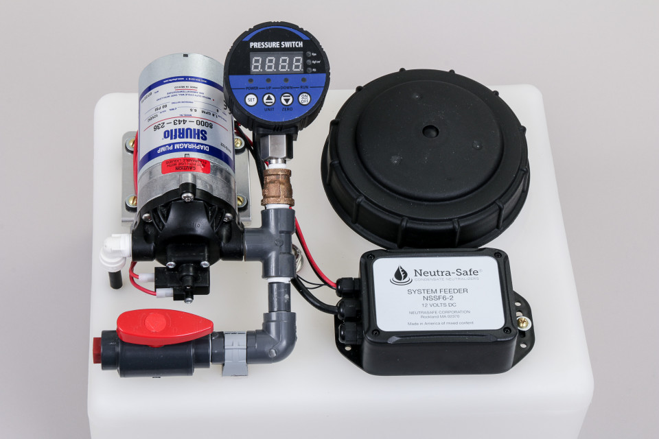

Neutrasafe Corp., in Rockland, MA, now offers an automatic hydronic and thermal solar system feeder, in addition to their newly-expanded line of condensate neutralizers.
The System Feeder introduces fluid and accurately maintains pressure in closed-loop systems. The easily-installed unit is designed for use with water or glycol solutions of up to 50 percent. A digital pressure control allows individually adjustable cut-in and cut-out pressures points between 1 and 50 PSI, with a secondary pressure switch cut-out at 60 PSI.
The System Feeder’s six-gallon tank is equipped with a set of dry contacts to connect to a remote alarm if the fluid level gets too low, and can be used with a standard 115VAC outlet. Because it features a commercial-grade diaphragm pump with internal check valve, it eliminates need for a PRV and backflow preventer. The System Feeder also limits the amount of fluid that can be lost in the event of a major break.
