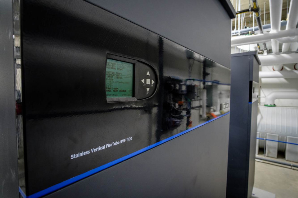

“We have a long standing relationship with Weil-McLain, and we trust the quality of their boilers,” said Cameron. “The SVF boilers were the perfect match for the space.” To meet the building’s heating style and load, the team installed two SVF 1100 MBH high-efficiency condensing gas boilers in the building. The SVF boilers features industry-leading thermal efficiencies up to 97.1%, a clover-shaped stainless steel fire tube heat exchanger for corrosion resistance, and the intuitive and user-friendly Unity™ control system to simplify installation and operation.
“With superior thermal efficiencies, the SVF line offers cost savings and energy efficiencies that could allow owners to qualify for local utility rebates, if available,” said Craig Demaray, National Sales Manager with Weil-McLain Canada. “The SVF also meets all market-driven bid specifications, and is designed for most heating needs including applications in schools and other educational facilities, public institutions, healthcare buildings, offices, hotels, multi-family, churches and more.”
The high-water content design of SVF heat exchanger means a low loss header is not required providing cost savings so the boilers can simply be piped in a primary-secondary design. The on-board Unity™ control system allowed the boilers to communicate with each other in a Multiple Boiler System (MBS). In this configuration, a master boiler controls the modulation and sequencing of the boilers on the network to achieve the desired system supply temperature. “With the automatic sequencing feature, the boilers communicate directly with one another so they sequence themselves and rotate as needed,” said Cameron. “They operate to optimize energy use and efficiencies. When heat is required, the boilers will stage on as needed.”

“The start-up and installation progressed smoothly in part due to the way these boilers are designed,” said Cameron. “The SVF boilers offers time-saving installation features that include heavy-duty roller casters for improved maneuverability in confined spaces, industrial-grade leveling legs, and an end-shot burner design requiring only 18 inches overhead space.” Mahmoud appreciates the ease of maintenance that the boilers offer for the building staff.
“The boilers are really user friendly,” said Mahmoud. “We can even conduct the annual maintenance on the units ourselves to keep them in tip-top shape.” In addition to offering class leading serviceability, the new boilers also offer low operating costs and are expected to bring energy savings and a reduction in gas usage to the facility. But most important, Mahmoud reported that tenants are extremely pleased with the climate and comfort of the building.
