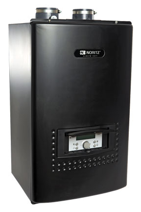

New two-in-one unit provides both domestic hot water and hydronic space heating for whole-house applications, even in colder climates, using condensing technology to maximize energy efficiency while reducing installation labor and cost.
The CB Series of Combination (Combi) Boilers from Noritz is a year-round, whole-home solution that utilizes high-efficiency condensing technology to deliver hot water to both plumbing and hydronic heating applications, including those in colder climates.
The CB Combi performs at a 95% AFUE (Annual Fuel Utilization Efficiency); that is, 95% of the Btuh input is converted into useable heat, making it an extremely energy-efficient appliance. This fuel-saving performance meets “Energy Star Most Efficient” standards, which represent the EPA’s highest efficiency rating and allow homeowners to qualify for various state energy rebates.
Delivering up to 9.2 gallons per minute of domestic hot water, the CB Combi provides nearly twice as much flow as competitor models. A flow control valve, not offered by competitors, ensures a consistent temperature for domestic hot water demand, regardless of incoming water temperature. This allows greater domestic hot water flow and more precise temperature stability, translating to a higher level of customer satisfaction.
On the space heating side, the Combi accommodates a host of multiple-room applications including radiators, baseboards, low- and high-mass radiant heating (i.e. in-floor, snow melt, etc.) and air handlers.

The compact size, ease-of-installation, high-efficiency and superior domestic hot water performance of the Noritz CB Combi add up to an all-in-one solution for a home’s heating and hot water needs.
