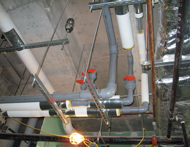

The new PPI Technical Note TN-65 “Insulation Recommendations for Plastic Pressure Piping Materials in Residential Applications” focuses on insulating plastic pressure piping materials against freezing. It applies to hot- and cold-water piping materials CPVC, PEX, PE-RT, PEX-AL-PEX, PP-R, and PP-RCT, and is directed to applications such as plumbing distribution, fire protection, and hydronics.
According to PPI, although plastic piping materials are inherently better insulators of heat energy than traditional metal pipe materials such as steel and copper, there are several situations where plastic pipe materials should be insulated for protection against freezing of fluids within the pipes.
“Insulation will of course reduce heat transfer through the walls of piping materials,” explained Lance MacNevin, P. Eng., director of engineering for PPI's Building & Construction Division. “This improves system efficiency and performance in a wide range of applications. Energy savings and faster delivery of hot water are other benefits of proper pipe insulation. TN-65 provides recommendations to prevent freezing in a variety of applications, based on multiple industry publications and the collaborative input of PPI members. It also addresses the use of heat trace cable and shares techniques for thawing frozen plastic pipes. It’s intended for plumbers, builders, designers, inspectors, and others.”
