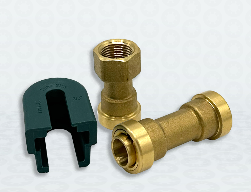

A patented double O-ring and grip ring seal delivers a secure, leak-free connection that withstands galling, vibration, pulsation and extreme temperature changes. The heavy-duty body is corrosion- and UV-resistant for long-lasting performance, while yellow protective caps keep debris out during handling and installation. These fittings are designed for residential and commercial HVAC/R applications and are compatible with copper and coated aluminum line sets, as well as HVAC/R units and unitary indoor coils. They are approved for use with industry-standard refrigerants, including A2L-class refrigerants R-452B and R-454B. Unlike permanent solder/ brazed fittings, QuickFitting’s Push-to-Connect fittings are removable using the patented HVAC Slip Clip™ Release Tool.
Installation is reduced to a simple four-step process: Clean, Debur, Mark and Push. The process begins with cutting the tube at a straight angle and thoroughly cleaning it using an abrasive cloth. The next step involves deburring the inside and outside edges to achieve a smooth finish. Once prepared, the tube should be marked with the correct insertion depth before pushing the fitting onto the tube up to the marked line - no additional tools are required. To remove installed fittings, the system charge must first be isolated or removed to ensure safety. The Slip Clip™ is then slid onto the fitting end, and once properly aligned, the fitting can be pulled away from the pipe to release the connection.
