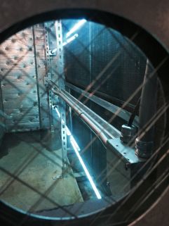

The RLM Xtreme is a high-output fixtureless system that offers the flexibility to be easily configured into most any HVAC plenum. The configuration installed in the hospital cafeteria’s AHU consisted of four T5 (5/8-inch diameter), 61-inch long UV-C lamps, a unique LampHolder that allows the lamp to be affixed in any position inside the air handler, and a power supply with a powder-coated, heavy-gauge galvanized steel and NEMA-2 rated housing. Its EncapsuLamp™ (FEP lamp coating) technology protects the system and airstream from glass and mercury residues should an accidental lamp break occur.
The UV lamps were installed on the downstream, air-exiting side of the coil, where they are most productive killing mold and bacteria and degrading all other organic materials. The UV-C wavelength removes this organic growth rather quickly, often in less than one month – a process that doesn’t produce any residual matter. A properly sized and installed set of lamps will noticeably clean a coil in about 30 days with continued improvements up to one year later on severely clogged coils. The UV-C fixtures can be installed in about two hours at an installed cost (materials and labor) of roughly $0.15 or less per CFM of airflow capacity. For the Kentucky medical center, the UV-C installation represented about 10 percent of the cost of a new, replacement coil.
