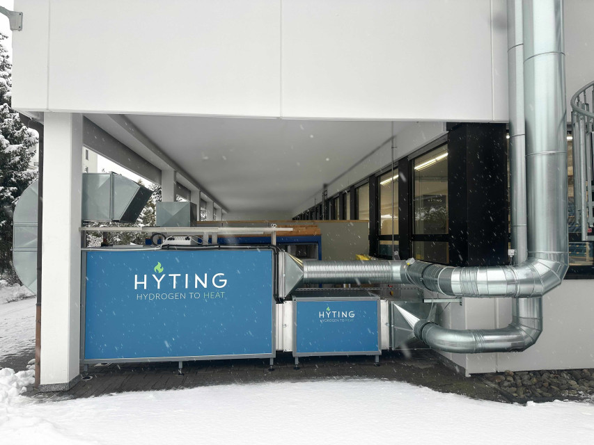

Hydrogen heating technology company HYTING has successfully commissioned its first customer installation. This marks a major milestone for the company and a world-first for the heating sector: the first catalytic hydrogen-powered air-heating system in operation at a customer site.
Located at Flusys GmbH’s newly-established production facility for precision pumps in Offenbach, Germany, the 10kW air-heating unit is now fully operational and heats a 1,000 cubic-meter space using hydrogen from a nearby supplier.
HYTING’s 10kW unit is matched to a heat pump to form a hybrid heating system. In this configuration the HYTING unit provides peak heating capacity during periods of high demand or in low ambient temperatures, with the heat pump managing the base heating load while running at its most efficient operating point.

HYTING's technology is based on a proprietary flameless catalytic process in which hydrogen reacts with oxygen from ambient air to generate heat – without producing any CO2, NOx, or particulate emissions – the only by-product is water vapour. Furthermore, it does not use flammable concentrations of hydrogen at any operating point, making it inherently safe.
The quality and robustness of HYTING’s technology has been proven by one of the world’s leading engineering service providers in a 2,500-hour durability test on a 10kW heat generator: simulating 10 years of real-world operation, it was completed without failures or measurable wear on safety-critical components. HYTING has also achieved Gas Appliance Regulation (GAR) certification for its technology and is now fully certified for field test operation.
