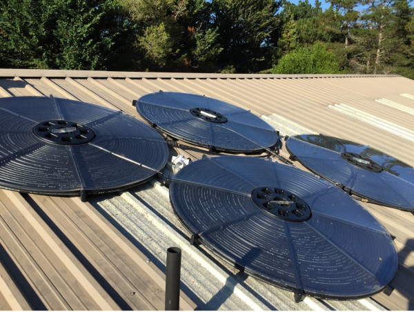

Following is the thinking that got us there. Wanting efficient collectors forces us to build more complex, expensive systems due to overheating and freeze concerns. It turns out that efficient collectors are better at losing heat to a clear night sky than inefficient collectors, so are more prone to freezing. So, instead, we used really inefficient collectors! These are simply coils of ¾” polyethylene tube, under an acrylic glazing. There is no insulation in the collectors, so they cannot easily overheat and are unlikely to be damaged by freezing, because the plastic tubing can expand somewhat. Also, we got to run the domestic water through the collectors directly, so a heat exchanger and other equipment were not needed. The hottest we’ve measured in summer with no water flow is 170 F in the collectors, and they have frozen multiple times without problem. This type of collector has been under test in San Jose, California, for over sixteen years with no trouble. Essentially, they are pool collectors, modified to produce domestic hot water, simply by adding an acrylic glazing. They are commercially made by Gull Industries in San Jose, CA. Here is what the coils look like installed on Zak’s roof.

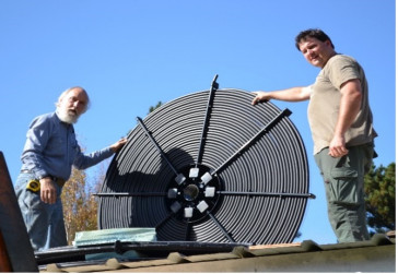

Four coils of ¾” poly pipe, 300 feet each.
The coils are 26 square feet each. Another benefit of using “inefficient” collectors is that we eliminated the need for copper pipe to and from them, but instead were able to run PEX tubing. With traditional copper collectors that can stagnate in the summer sun at up to 400 degrees F, PEX tubing would melt pretty fast. But we were able to use poly pipe and PEX for nearly everything, simplifying the job even further. We purposely oversized the system, so it could coast through periods without sun and recover quickly when the sun returns. When overheating is no longer a concern, oversizing loses that drawback.

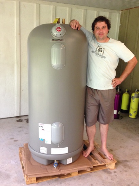

The tank was another consideration. Normally, with any glass-lined tank (nearly all tank-type water heaters in the US are glass-lined), you want to turn over the volume of the tank daily to prevent stagnation and odor problems. Turns out the anode that comes with all glass-lined tanks generates hydrogen gas, which some anaerobic bacteria really like. We got around this by installing a 105-gallon Marathon tank, by Rheem. This is a non-metallic tank that needs no anode, so does not “age” the water like glass-lined tanks do. The benefit of this much storage is the ability to survive happily through up to four sunless days. Here is what the tank looks like:
Zak Vetter, who is six foot, two inches tall, and the Marathon tank.

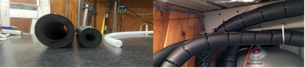

One other benefit of the Marathon tank is its insulation. It’s got three inches of foam, and the literature says it loses only five degrees F in 24 hours. Our data-logging suggests it’s more like six to eight degrees in our situation, but still, not bad. Insulation is something else we played with. Pipe insulation seldom comes really thick, yet keeping heat loss down increases the actual solar fraction and reduces the amount of back-up energy needed. So we decided to double up on the insulation where possible. Here are photos of how that worked:
3/4” PEX pipe with two layers (1.5”) of insulation. Looks like big pipe when installed.

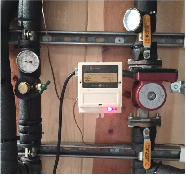

Solar control with pump and thermometers.
The system is managed simply with an off-the-shelf Goldline GL-30 solar controller. It measures the temperature at the solar collector and at the bottom of the tank. It compares the two and, when the collector is sufficiently hotter, turns on the pump, which moves about one gallon per minute through the roughly 1300 feet of ¾” tubing, with the collectors hooked up in series. The control has adjustments for fine-tuning this set-point. Fortunately, we do not need the control for freeze or overheating protection.

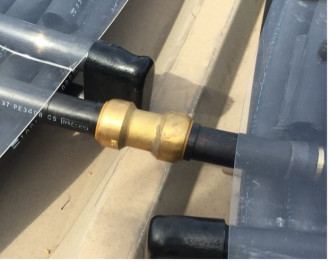

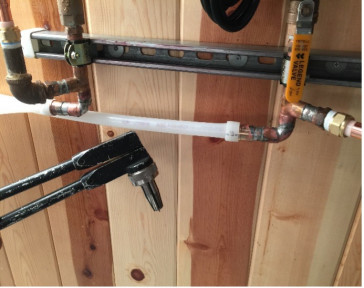

- Exposed connections were done with push fittings (Sharkbite).

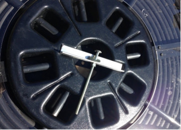

- Collectors were installed on the roof using only one central bolt.

Here are photos showing some of the time-saving hardware.

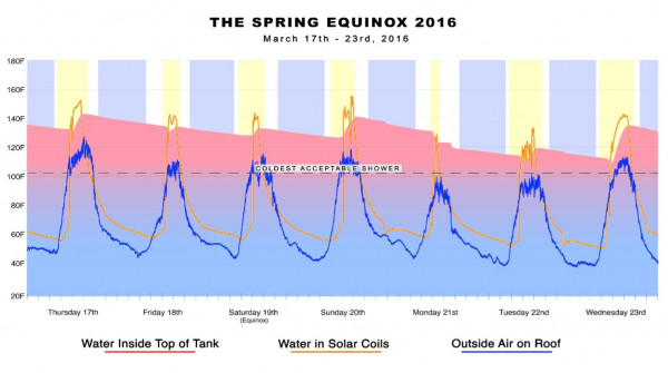

Performance so far has been good. We’ve data-logged at multiple points across the system in order to understand just how it’s working. Following is a graph of the Spring Equinox performance. You’ll see that the system produced water ranging from about 110F to a little over 140F.

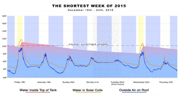

Following is a graph that show the system at its worst. The vertical yellow bars represent periods of sunshine, and the vertical blue bars are night time. Between the 21st and 22nd you’ll even see rain! But note how just a few hours of winter sun on the 23rd gives the tank about a 20-degree boost.

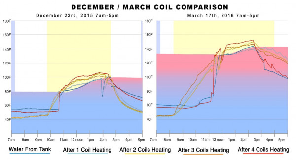

Another two graphs show the differences between December and March. Note that, in these graphs, we measured outputs from each collector to see if all four were useful. It turns out that the first two collectors gathered more BTUs, but the following two collectors each bumped the temp up higher, so they really did help--particularly during the colder times of the year.
