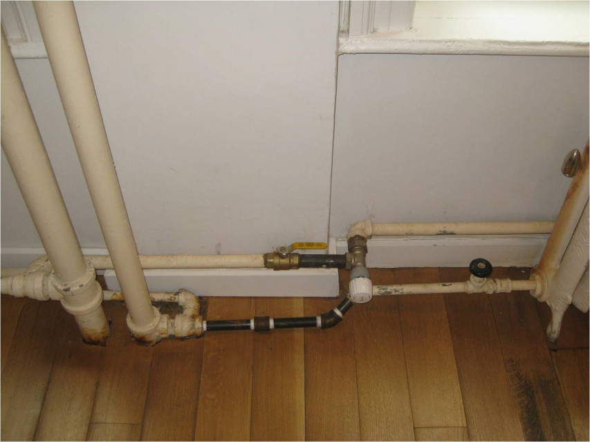

I’m seeing the problem and asking the questions to confirm what I already suspect. Thermostatic steam traps for radiators arrived in 1905. This building went up in 1901, so the builder used a two-pipe, air vent system for the first phase. The supply main is two-inches in diameter and rises from the basement to the top floor. The return main is 1-1/2-inch and stands right next to the supply main. Off of these two vertical pipes are the radiators, set like rungs on a ladder. This system is the missing link between one- and two-pipe steam. They used it in tall buildings at the Turn of the Century because a building this tall wouldn’t work well with one-pipe steam if the supply came up from the basement. All the condensate draining back down that tall riser would kill the steam trying to make its way up. So they put air vents on all the radiators and drained the condensate from each radiator through a return riser. They would make that riser one size smaller than the supply riser so the steam would favor the supply on start-up, but once the system was hot, there was going to be steam in both the supply and return risers, and that was perfectly normal.
The law office was overheating because the radiators were sized to heat the space when they had 1901, single-pane windows. Now they had modern windows and they were gagging. So a contractor installed thermostatic radiator valves on the supply side of all the radiators. The steam looked at those TRVs, shrugged and used the return lines to overheat the radiators. Steam is like that. It’s just looking for an air vent.
The system had a Heat Timer that lowered the temperature over the weekend, so when the steam returned on Monday morning, it hit tons of cold steel and made lots of condensate, which it knocked around like a demolition derby. After the pipes got hot, there was less condensate and less banging, but there was still that oppressive heat. I explained that the supply-side TRVs weren’t going to work. They had to use the sort of TRV that went between the air vent and the radiator. Either that or they would have to convince all the other tenants in the building to install supply-side TRVs and thermostatic radiator traps. Good luck with that.
We went from floor to floor and found similar situations. This is a building where the companies buy the floors that they’re on and then never speak to their neighbors. They’re all sharing an antique steam system and they think they can do what they want with just their part of it. They can, of course, and they do, but it won’t work because of the physics. It’s tough arguing with physics.
The one-pipe radiators on the top three floors connected off the supply riser and drained back into it. There were acres of people working quietly at computers on these floors. In some of the spaces, the architects had the heating contractors move the radiators between those two windows way over there. Having the radiators in the middle of the windows was aesthetically pleasing to the eye, but the horizontal pipes running to those now-far-from-the return-riser radiators either didn’t pitch back toward the return riser, or pitched the other way, so they were arguing with gravity. I asked the quiet people at the computers if their radiators were noisy. They all winced.
Downstairs in the boiler room, I checked the pressuretrol and found the system set to run between 5-1/2-psi and 7-1/2-psi, which is about five times higher than it should be, and well beyond the operating pressure of one-pipe steam air vents. That means that the steam pressure was able to lock closed the air vents after the first cycle. That leads to very uneven heating.
