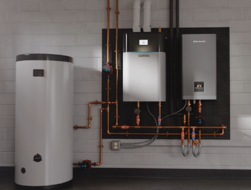

Dual-fuel systems integrate an air-to-water heat pump with a traditional hot water boiler, where the heat pump manages a significant portion of the seasonal heating load, and the boiler supplements heating only during extreme cold. This approach balances efficiency, performance and comfort while ensuring redundancy and reliability. Most hybrid systems transition to boiler backup around 30°F (+/- 10°F) to ensure optimal efficiency and comfort.
Photo: Indoor split units integrate an air-to-water heat pump into an existing gas boiler system to manage heat pump operation and ensure seamless transitions between heat sources.

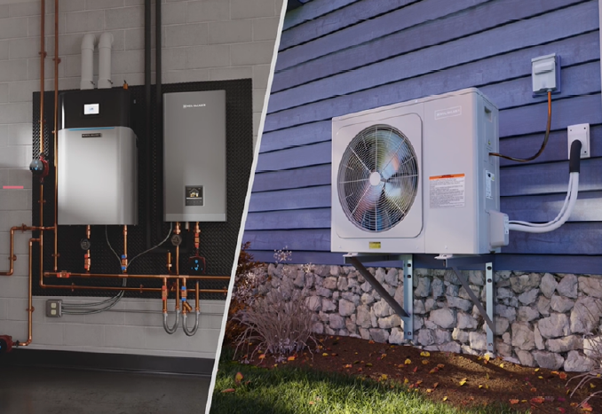

Image: Dual-fuel systems are important because they reduce reliance on fossil fuels, improve energy efficiency and lower greenhouse gas emissions.

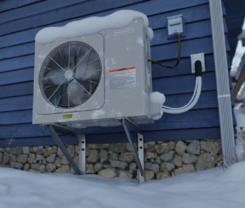

Photo: Heat pumps operate best in warmer “shoulder seasons,” maximizing efficiency and carbon reduction.

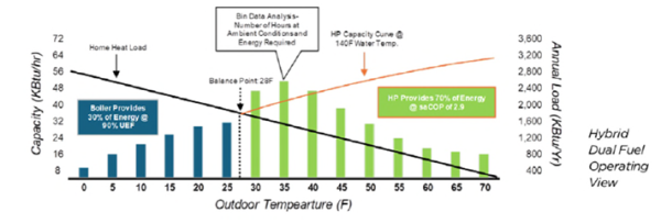

Smart System Design: Performance Calculators for Optimized Efficiency
To ensure efficiency and ease of integration, advanced performance calculators have been developed to support system design. These tools:
- Conduct load calculations (Manual J) for precise system sizing.
- Analyze efficiency projections using bin data to maximize heat pump contribution.
- Enable data-driven decision-making to prioritize comfort and cost savings.
- Ensure proper application sizing by factoring in heat load, heat pump capacity, heat emitter capacity, domestic hot water (DHW) needs, weather bin data, localized utility rates and rebates.
Chart: Advanced calculation tools simplify system design, helping to maximize efficiency and streamline integration for optimal heating performance.
