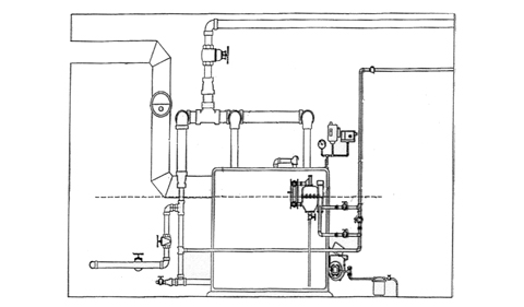

But today’s steam boilers can’t do this because they have to meet combustion-efficiency standards, which is ironic because if the steam is wet, the system efficiency suffers, even when the combustion efficiency looks great. And this is why it is so important for you to closely follow the boiler manufacturer’s installation instructions when it comes to near-boiler piping. But keep this in mind as well. Boiler manufacturers compete with each other. If Manufacturer A says you should use one riser to the steam header, Manufacturer B is going to be reluctant to say you should use two risers to that header because that would put them at a competitive disadvantage. But my advice is to use at least two risers to that header because that’s going to slow the steam velocity and give you dryer steam and better system efficiency (think fuel savings and no noisy pipes). If your customer tells you your price is higher than the other guy’s price, show them this column.
And if you want to make that replacement boiler operate even better, increase the size of the risers as they leave the boiler, just as Mr. King advised, and consider piping a drop header instead of a standard header. Drop headers bring the steam to a point that’s higher-than-normal boiler risers would go. From there, the near-boiler piping goes horizontal for a short distance and then drops to feed steam into the top of the steam header. The pipes will take that dry steam from the steam header to the radiators quickly and quietly. Drop headers leave the carryover water back in the boiler and the results are remarkable. If you want to see photos of drop headers, go to HeatingHelp.com. And ask about them on The Wall at that site. Some of the smartest steam people in the country will tell you the same things I’m telling you.
These days, the near-boiler piping is a part of the boiler; and whether or not that next replacement job works as it should is entirely up to you because you’re the pipefitter, and you’re in charge.
