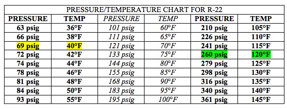

Q: What does a pressure/temperature chart look like?
A: Here is a portion of the pressure/temperature chart for R-22, which is a refrigerant commonly found in many heat pump and air conditioning systems.
From this chart we can see that saturated R-22 will be at a temperature of 40°F if it is at a pressure of 69 psig. (Refer to the yellow highlighted portion of the chart). We can also see that saturated R-22 will be at a temperature of 120°F if it is at a pressure of 260 psig. (Refer to the green highlighted portion of the chart).

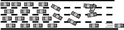

Q: What does the metering device do?
A: Like the compressor, the metering device is a system component that acts as a dividing point between the high and low pressure sides of the heat pump system. The metering device acts as a blockage in the refrigerant circuit and restricts flow as the refrigerant flows between the two heat transfer coils. The temperature and pressure of the refrigerant at the inlet of the metering device is high, while the temperature and pressure of the refrigerant at the outlet of the metering device is low.
Consider a car accident on a four-lane highway. Traffic builds before the accident, as a number of the travel lanes are blocked. This creates a “high pressure” of sorts before the accident.Now, consider what happens after the point of the collision is passed.The concentration of cars is low and the “pressure” is greatly reduced.

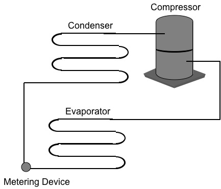

Q: How are all these components connected?
A: The four major system components that were previously discussed make upwhat is called the basic refrigeration cycle. These components are connected to each other as shown in this figure.
Q" How does the system operate?
A: Let’s start at the inlet of the compressor. At the inlet of the compressor,the state of the refrigerant is 100% vapor and is at a low pressure and a low temperature. As the refrigerant flows through the compressor, the refrigerant is compressed and the temperature and pressure of the vapor is increased. At the outlet of the compressor, the refrigerant is at a high temperature and a high pressure. Remember, because the refrigerant is 100% vapor, it does not follow the pressure/temperature relationship for that particular refrigerant.
From the compressor the refrigerant flows to the condenser coil. This is where system heat is rejected. As heat is transferred from the refrigerant to the surrounding medium, the refrigerant begins to condense into a liquid.Now the refrigerant is a mixture of liquid and vapor and it follows the pressure/temperature relationship for that refrigerant.
At the outlet of the condenser, the refrigerant is 100% liquid and then flows onto the metering device. This refrigerant is still at a high pressure and a high temperature. The metering device controls the flow of refrigerant into the evaporator by acting as a blockage. At the outlet of the metering device, the refrigerant is now at a low pressure and a low temperature. The low pressure, low temperature liquid then flows into the evaporator.
The evaporator is the point in the system where heat is introduced to the refrigerant. As heat is added to the refrigerant in the evaporator coil, the refrigerant begins to evaporate or boil. As the liquid refrigerant begins to boil, it once again becomes a saturated refrigerant, or a mixture of liquid and vapor.Since it’s saturated, it follows the pressure/temperature relationship for that refrigerant. At the outlet of the evaporator, the refrigerant is 100% vapor and ready to enter the compressor once again.

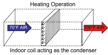

Q: How does the heat pump system provide heating?
A: The heat pump heats the air in the occupied space when the air passes over or through the condenser coil. Since the temperature of the condenser coil is higher than the temperature of the air passing through it, heat is transferred from the warm refrigerant in the condenser coil to the air, thus warming it.

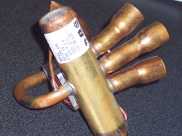

Q: What does the reversing valve look like?
A: Here is a photo of a typical heat pump reversing valve. The valve has the ability to change the direction of refrigerant flow depending on the mode the system is operating in.
The Reversing Valve

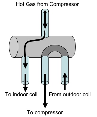

Q: How does the reversing actually redirect refrigerant flow?
A: The reversing valve has four ports:
• One port connected to the outlet of the compressor
• One port connected to the inlet of the compressor
• One port connected to one side of the indoor coil
• One port connected to one side of the outdoor coil
The reversing valve has an internal slide that ultimately determines the mode in which the system will operate.
For example, in the diagram that follows, if the slide is to the left, the refrigerant will flow from the compressor to the outdoor coil. When such is the case, the system is operating in the cooling mode, since the refrigerant always flows to the condenser first upon exiting the compressor. It can also be seen that the “U-bend” directs the refrigerant from the indoor coil, in this case the evaporator, back to the compressor.
When the system operates in the heating mode, the indoor coils acts as the condenser. In this case, the hot gas from the compressor is directed to the indoor coil, which is functioning as the condenser. It can be seen that the refrigerant from the outdoor coil, in this case the evaporator, is directed back to the compressor via the “U-bend” in the reversing valve.
You should be able to note that, in the following two photos, the direction of refrigerant flow through the tube on the left side of the valve remains the same, even though the slide has changed position. The same can be said for the center pipe connection on the right side of the valve. As the slide position changes, the direction of refrigerant flow changes only in the top and bottom pipes of the right hand side of the valve.
The two positions of the reversing valve.

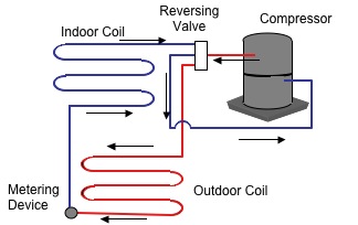

Q: How does the refrigerant flow through the system in the cooling mode?
A: The refrigerant (upon leaving the compressor via the red line in the following diagram) first flows through the reversing valve where it is directed to the outdoor coil. Since the refrigerant always flows to the condenser first after leaving the compressor, the outdoor coil is acting as the condenser. In this mode of operation, the heat from the refrigerant is rejected to the outside air. From the outdoor coil, the refrigerant flows through the metering device and then to the indoor coil, where the refrigerant picks up or absorbs heat from the air in the area being cooled. The refrigerant then flows back to the compressor via the reversing valve and the cycle repeats itself.

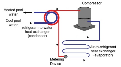

Q: Can you give me an example of a heat pump system that does not have a reversing valve?
A: The heat pump swimming pool heater does not use a reversing valve. The sole purpose of the heat pump pool heater is to heat the water in the swimming pool. This heat pump is never used to cool the pool water, so there is no need for the system to operate in both the heating and cooling mode. The heat pump swimming pool heater is an air-to-water heat pump and uses one air-to-refrigerant heat exchanger and one refrigerant-to-water heat exchanger.
The hot gas from the compressor is piped directly to the tube-in-tube heat exchanger and transfers heat to the pool water. The refrigerant leaves this heat exchanger as a high temperature, high pressure liquid and, after flowing through the metering device, flows to the outdoor coil as a low temperature, low pressure liquid. It is at the outdoor coil, the evaporator, that heat from the outdoor air is transferred to the refrigerant.
Simplified piping diagram of a heat pump swimming pool heater.

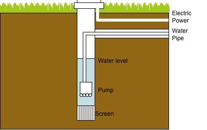

Q: What does a well look like?
A: From the top, the typical well does not look like much. Probably the only thing you will see is the well cap, which is the only part of the well that is above ground. Underground, however, there is a lot more going on. The well must be drilled deep enough to allow the pump to be positioned below the static water line, or water table. There is a screen at the bottom of the well that prevents foreign matter from entering the well and the pump. There is a water line, often referred to as a drop pip, that connects the pump outlet to the underground water line. The underground water line carries the water from the well to the heat pump system.

Q: How do wells provide water for the heat pump system?
A: Pumps are positioned at the bottom of the well to supply the needed water to the system. When the system is in operation and water is needed, the pump will turn on and pump water from the well to the water-refrigerant heat exchanger in the heat pump system.

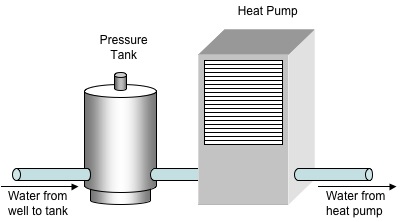

Q: Does the pump have to run whenever the system is operating?
A: Sometimes. If the system is not using a pressure tank, the answer is yes. This means that the pump will cycle on and off with the heat pump and can, in the event of system short-cycling, lead to premature pump failure. If the system utilizes a pressure tank, the pump’s run cycles will be less frequent.
Q: What exactly is a pressure tank?
A: A pressure tank is a tank that stores pressurized water until it is needed by the heat pump system. The pressure in the tank is maintained at a desired level. When the tank pressure is low, the pump is cycled on and water is pumped into the tank. Once the tank pressure reaches the desired level, the pump is cycled off. As the heat pump system operates, water is fed from the pressure tank and through the heat pump. When the pressure in the tank drops below a predetermined level, the pump is cycled on again to increase the water pressure in the tank. The pressure tank is located between the supply well and the heat pump.

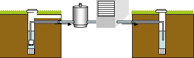

Q: How is a two-well (supply and return) system configured?
A: The two-well system utilizes one well to supply the water to the heat pump system and another well to receive the water that has already flowed through the heat pump. The configuration is shown in the following diagram. The supply well feeds water to the pressure tank, which feeds water to the heat pump. Once the water has passed through the heat exchanger in the heat pump, the water is then sent back to the ground via the return well. The wells should be at least 100 feet from each other to prevent the heat from the water in the return well from affecting the operation of the system. Here's a drawing of a two-well system.

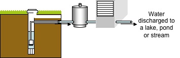

Q: How is a one well system configured?
A: If the system is located near a pond, river or lake, the water that is discharged by the heat pump system can be directed to it. In this configuration, the water is brought to the system by the well and then discharged directly to the pond, river or lake. Since the water does not come in contact with any chemicals or other substances within the system, no environmental damage results. It is important, though, to check with local codes and guidelines relating to the installation of this type of heat pump system. A one-well system utilizes a lake, pond or stream to accept the water discharged from the system.

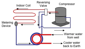

Q: How is heat transferred from the water in the Earth to the heat pump system?
A: The water in Earth and the refrigerant in the heat pump system pass through a tube-in-tube heat exchanger such as this one. The tube-in-tube heat exchanger is configured as a tube positioned within another tube. The water flows through the inner tube while the refrigerant flows through the outer tube.
In the heating mode, heat is transferred from the water to the refrigerant, causing the refrigerant to boil to a vapor at low temperatures. In the cooling mode, heat from the hot vapor refrigerant is transferred to the water, rejecting heat from the system and allowing the refrigerant to condense into a liquid. In the following two diagrams, the outer circle represents the refrigerant path while the inner circle represents the water path. The light blue indicates the lower temperature fluid and the red represents the higher temperature fluid. In the cooling mode, the high temperature refrigerant transfers heat to the cooler water, which is then transferred back to the Earth.
In the heating mode, the higher temperature water transfers heat to the cooler refrigerant, which is then transferred to the medium being heated.

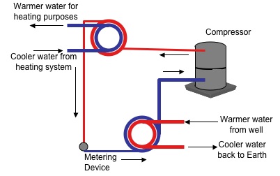

Q: What would the piping diagram look like for a water to water heat pump?
A: A water-to-water heat pump uses water as the heat source to ultimately heat water. Since we are heating water with water, both heat exchangers will be of the tube-in-tube variety. Here is a simplified piping diagram of this type of system.
