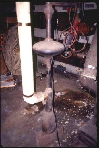

Anyway, Dave called me one day because he had come across this Heat Generator thing, which he had never seen, and neither had I. “It’s made of iron and looks like one of those old-fashioned, floor-standing ashtrays,” Dave said. “And cast into its top are the words, Honeywell Heat Generator Number One. I know they had to start somewhere with all those numbers, and it looks like I’ve found where they started. I got Numero Uno!”

When I got there, Dave had disconnected the Heat Generator. His guys were tearing down the boiler, which was the size of my kitchen. “It’s over here,” Dave said, walking over to the odd device and picking it up. He shook it. “There’s something inside of it,” he said. He shook it again. “It’s probably sludge. It’s been on this system for all these years. I’ll bet it’s some sort of dirt collector.”
“Why would they call it a Heat Generator if all it does is collect dirt,” I said.
I figure that at this point, Mr. Mark Honeywell, wherever he was, was laughing himself silly.
“Maybe it makes the heat generate faster because it gets the dirt out of way,” Dave said. “I don’t know. I’ve never seen one of these before.” He shrugged and tipped it over as I stood there like a silly idiot and watched.
What poured out was about a pint of pure mercury, which hit the floor like a liquid lawsuit. I looked at Dave and Dave looked at me. You could have fit a softball in either of our young mouths.

That’s what was rolling through Mr. Honeywell’s mind. He designed the Heat Generator to be a pipe within a pipe, and one of those pipes dips into a pot of mercury. He connected one pipe to the hot-water supply line, and the other to the open tank in the attic. The mercury pot separates the two pipes. When the water in the system heats and expands, it pushes down on the mercury, which acts like a spring. As the water presses down, the mercury rises up the inside of the submerged pipe. If the system pressure goes higher than 10-psi, the water separates from the mercury and relieves the excess pressure into the open expansion tank in the attic.
So you wind up with a hot-water system that’s open to the atmosphere, but still able to make water (under 10-psi pressure) rise to 240-degrees F. And water that hot sure circulates quickly!
It was brilliant and so was he, and in a way, he gave us our first “circulator” because the Heat Generator made the water move more quickly in a gravity system. It caught the attention of the Minneapolis Heat Regulator Company and the rest is history.
There are still plenty of Heat Generators out there. I talk to contractors who run across them all the time. A device that has only one moving part (the mercury) will last for a very long time. If you should come across one, please don’t tip it over. Leave that to dearly departed Dave and me. We’re more than happy to be your idiots by proxy.
