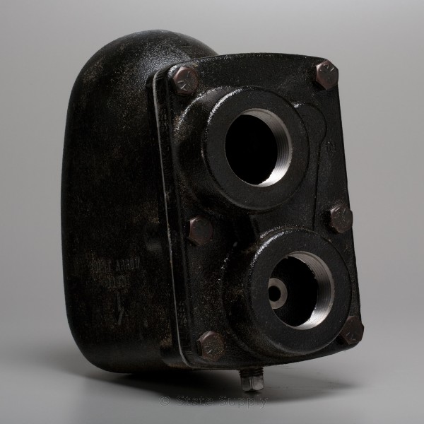

Anyway, on this job, the engineer had specified these float-and-thermostatic steam traps that the company we represented made. The traps had failed and the engineer wanted to know why. They were all passing steam into the return lines, and when that happens, some of the tenants aren’t going to have any heat because steam in a return line blocks the air that’s trying to leave the system. And where there is air, steam will not go. It also causes water hammer that can lift the building off its foundation. So there we were.
Now this seemingly guilty trap was at the base of a two-inch steam riser that went from the basement up to the sixth floor, feeding six radiators as it went. The radiators also had steam traps, of the thermostatic variety, and any condensate that formed inside the radiators when the steam gave up its latent heat energy would drain through those traps and back into a dry return line. The dry return worked its way back to a boiler-feed pump. It was standard steam stuff; the supply-and-return risers were like the two sides of a ladder, and the radiators on each floor were like the rungs on that ladder.
The trap that the engineer and I were looking at had just one job – it had to drain the condensate that formed in the two-inch riser when the pipe first got hot. It didn’t have to handle any of the condensate that formed in the radiators; the radiator traps took care of that. So we were asking this trap to deal with just the water that would form when about 50 feet of two-inch diameter, insulated pipe went from ambient temperature to 215-degrees Fahrenheit. Can’t be much water, right? And once the pipe gets hot, it stops making condensate. I knew that the trap was too big, and that’s why it, and all the others, had failed.
“Why did you spec a two-inch F&T trap for this line?” I asked.

“Well, how about this?” I said. “If you were going up 300 feet, you’d use a three-quarter-inch F&T. That would be the right size. A two-pipe riser that’s this short doesn’t make that much condensate. The trap is oversized, and that’s why it’s failing.”

“Trouble is, when an F&T trap is oversized,” I said, “it barely has to open to release the little bit of condensate it collects. And when that happens, the pin stays too close to the seat inside the trap. The condensate moves so quickly across that tight space that it erodes the surfaces. That’s why this trap is passing steam. It’s way too big, and your client paid way too much. If you rebuild the trap, or replace it with another of the same size, the same thing is going to happen again. If you keep doing what you’re doing, you’ll keep getting what you’ve got. In fact, a three-quarter-inch trap would be oversized for this duty. Sure, it would be better than what you’ve got here, but it would still be too big.”

So here’s the thing: Within the realm of space heating (and please don’t apply this to commercial systems), if the trap is the same size as the line that it’s on, it’s the wrong size trap. This will be true every single time. Line size is the wrong size. That trap will always be oversized, which means that someone paid more than he or she should have paid for a trap that’s going to fail long before its time.

The right way to size a steam trap is to figure out how much load the trap is going to see. You do this my considering what the trap is serving. Is it at the end of a steam main? Is it on a unit heater? Is it at the base of a riser? If it’s a heater of some sort, the manufacturer will be able to tell you the load. If it’s serving a main or a riser, you’ll have to figure out the length of the pipe and take it through its temperature rise to figure the pounds per hour of condensate that you’ll get when the pipe first heats. There are good books available that will give you that that information.
Next, you have to know the differential pressure across the trap. In space-heating work, that differential pressure is usually very low because most buildings heat on 2-psi pressure or less. If a line gets back-pressured (because a trap somewhere is passing steam into a return), it will affect the performance of other traps, making them look bad when they’re really not. You have to look at big pictures when you’re sizing traps.
