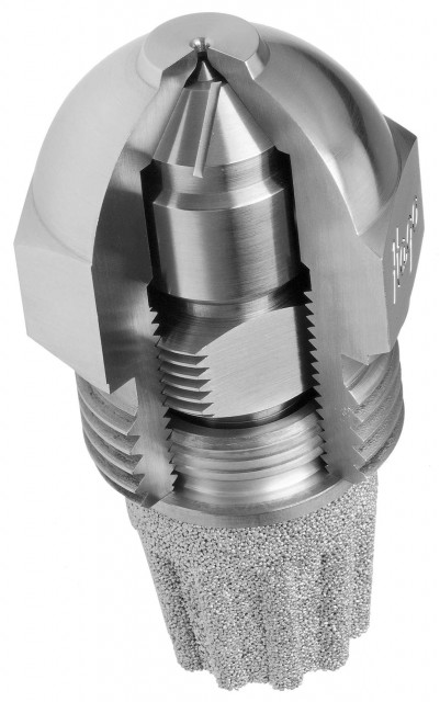

They’re making nozzles for oil burners in this building, very similar to the ones Knud Mölholm made in Denmark, but here, they also make nozzles for fire-suppression systems that spray mists of water at 1,400-psig pressure to extinguish fires on ships and in European buildings. We have no such systems in the U.S. This system puts out the fire without drenching the building.
“These nozzles must be perfect, Andrew Kozdron, Production Man, tells me. The first indication of a failure would be that the building or the ship burned down.
“That’s not acceptable. There is absolutely no allowance for error when we make these,” he says, handing me one. It looks like a Swiss watch. “This is a life-and-death issue. We must be perfect every time. There’s no margin for error.” He looks me hard in the eye. He needs for me to understand that. He waits.

Nozzles are cheap. You can get them for a couple of bucks. But then, as I did in Denmark years ago, I watch them being born. The steel is indeed special. It has to be because a nozzle has so many surfaces, and each surface must be just right if the flame is to swirl properly and burn cleanly, and if the water is to put out the fire in the building or on the ship. There’s intricate machining on the inside and the outside of each nozzle. Every cut and bevel matters.
And have you ever considered the size of the hole in an oil-burner’s nozzle? Take a close look when you have a moment. That hole is not just tiny; it’s also machined with specific, microscopic bevels that launch and spin the flame, making it dance like a ballerina.
“Look at this tool,” Production Man says, handing me a sliver of steel a quarter the length of a sewing needle. “Can you see the cutting edge?” I look more closely but my eyes are not good enough. “Put it here,” he says, moving me over to a lighted magnifying glass. I do. I turn it and find the right magnification, and then I gasp at what I’m seeing. The edge, which is miniscule, is also flat and sharp. It’s like looking at a grain of machined pepper.”
