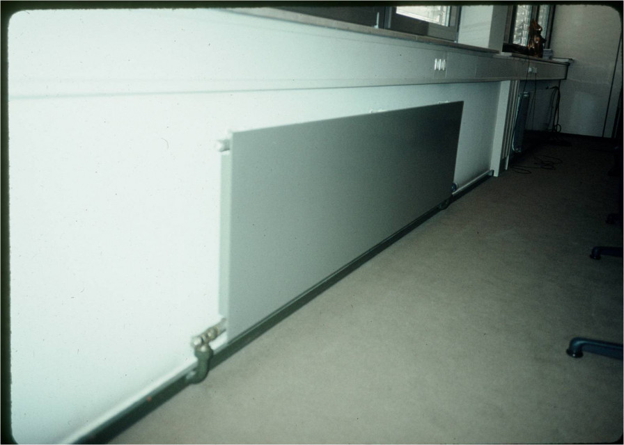

Years later, I found myself in a suburb of Frankfurt, Germany. A few friends and I were in the office of this big design/build firm. We were visiting the big ISH tradeshow that year, and were on a side trip to get some insight into how the Europeans design their hydronic heating systems. The fellow who was lecturing us that day did so in German, but we had a translator with us, and he was a huge help.
This was the day that I learned that the main difference between them and us is that they focus on pressure differential while we focus on big flow rates. They run little pipes from the boiler to manifolds, and they then connect their panel radiators to the manifolds. The radiators all have thermostatic radiator valves. They run continuous circulation between the boiler and the manifolds, and they let the TRVs modulate the flow between the manifolds and the panel radiators. They also install differential-pressure regulators between all their supply and return lines so that the TRVs can throttle without backing the circulator up on its curve. That solves the problem of banging control valves and velocity noise, both of which are also American traditions.

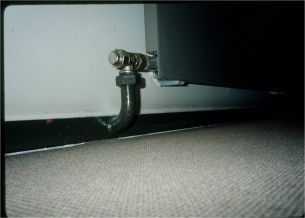

During a break, I wandered over to one of the panel radiators that were under the window of this large conference room. The radiator had a TRV, of course (they're required by law for rooms larger than eight square meters in Germany), and the supply and return pipes looked like they were going right through the wooden base molding and into the wall. I thought that was strange, especially since the building was old and the walls were made of concrete, so I asked about it. "Why do the pipes go into the wall?" Our translator turned to our host and repeated my question. Our host looked confused. I pointed and gestured. He started laughing. Then he explained, through our translator. "The pipes do not go into the walls," he said. "That is the pipe." And he pointed at what I had thought was wooden base molding. It wasn't molding. It was a pipe.
"That's the pipe?" I asked. "That square thing?"
Translator, back to our host. Host nods.
"Why is the pipe square?" I asked.
Translator back to him, and then back to me.
"The pipe is square because the corner is square."
"Oh," I said.
"Square pipe fits in square corner," he further explained to Big Stupid. "Round pipe, square corner, not so good."
"Oh."
Turns out, this square pipe ran around the perimeter of the office building, feeding panel radiator after panel radiator, much like we would do with a diverter-tee system here in America. One of my traveling buddies looked at this and chuckled. "They must have some sort of diverter tee in there," he says. "Otherwise, water won't flow from the square pipe into the radiator." I nodded. "Ask him," he said.

But I soon learned that the pressure drop through a panel radiator is so slight that the water favors it over staying in the square pipe. Who knew?
