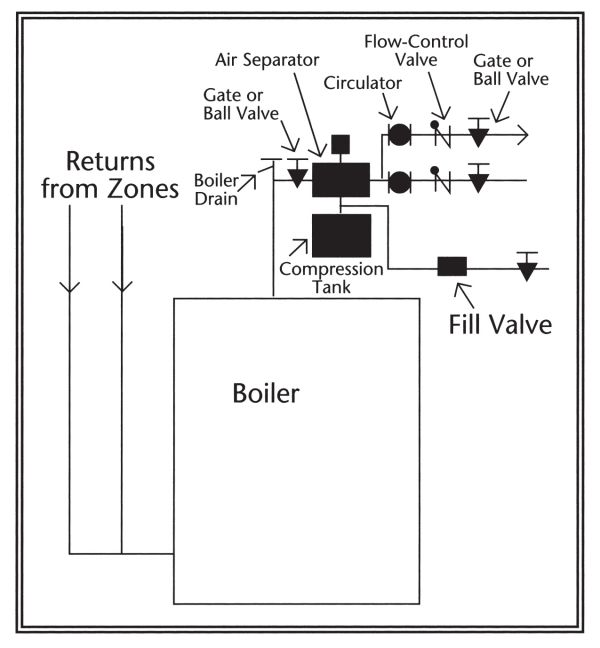

near boiler piping with two circulators
You leave the boiler with a full-size supply main and enter a tee. Pipe a 1/2" boiler drain into the top of the tee. That's going to be the purge valve for your system. You only need one purge valve. You take the money you were going to spend on the other purge valves and you go buy something nice for yourself.
Now, come off the side of the tee, keeping the pipe full size as you go, and install either a ball valve or a gate valve. You'll be using this valve for service, as well as for your initial air purge.
Your air separator comes next. If you're using a scoop- or orifice-type air separator, you'll need to allow 18 inches of straight, full-size horizontal pipe at the inlet to the air separator. The manufacturers of these types of air separators call for this approach piping. They need it to get the maximum efficiency out of their units. If you're using a microbubble reabsorber-type of air separator, you won't need this approach piping; you can install this type of air separator right next to the ball or gate valve.
Okay, next we have the compression tank. You'll attach it to, or very near the air separator. In this example, I'm using a diaphragm-type tank. I'll show you how to use a plain-steel tank in a minute.
Bring your feed valve into the line connecting the diaphragm tank to the system piping. That's the point of no pressure change, the only place in the system where the pump can't affect the feed valve. You'll be using the feed valve, the main service valve and the tee-mounted boiler drain to power purge the air from the system. You push it all in one direction.
That's one of the best things about this piping arrangement. It lets you power purge toward the system piping and up through the bottom of the boiler. You can power purge one zone at a time and never wind up with a big bubble of air trapped inside the boiler. This, whether you realize it or not, often happens when you pipe your feed valve into the boiler and your purge valves on the return. You need that one main shut-off valve to get everything going in the same direction.
Okay, next come your circulators. Here, I'm using two, but you can have as many as you'd like. After each circulator, you'll pipe in a flow-control valve to prevent gravity circulation and short-circuiting, and then a ball or gate valve for service and the initial power purge.

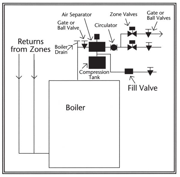

If you prefer to zone with valves instead of circulators, pipe the job like this.
near boiler piping with zone valves
In either case, you'll get rid of your initial air by closing the main service valve and the zone service valves. Next, open the feed valve and the tee-mounted boiler drain. Then, open one zone at a time. It's like firing torpedoes.
The water will flow through the first zone, pushing air ahead of itself. The air will zip through the boiler and leave the system by way of the tee-mounted boiler drain. The water will also fill the boiler.
When the water runs air-free, close that zone's service valve and open the next zone's service valve. Bam! The water will push the air through the second zone and the already-filled boiler.
If you have a dozen zones, do this a dozen times. You only need that one power purge valve, and you won't wind up with that big bubble in the boiler.
