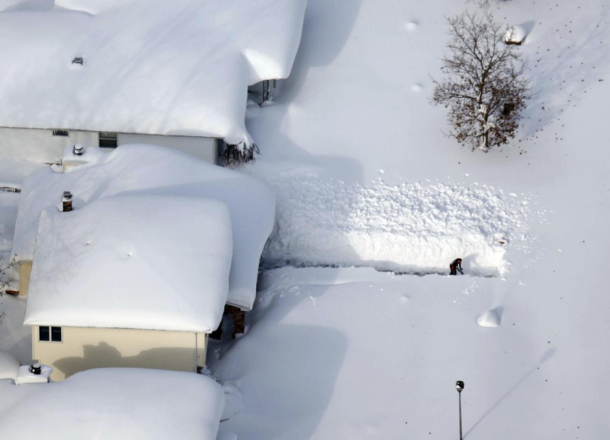

When deep (and persistent) snow arrives, danger arrives with it.
I asked the professionals on The Wall what homeowners should do (and not do) to stay safe and here's some of what they had to offer:

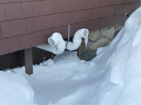

- Check to be sure that sidewall vents (furnace/hot water/dryer) have not been blocked by snow. Good combustion needs air, and without it, we get carbon monoxide.

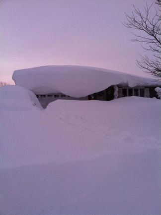

- Also, not just sidewall vents. In some structures the roof drifts can get to four or five feet (or more!), and the roof needs to be checked, too.

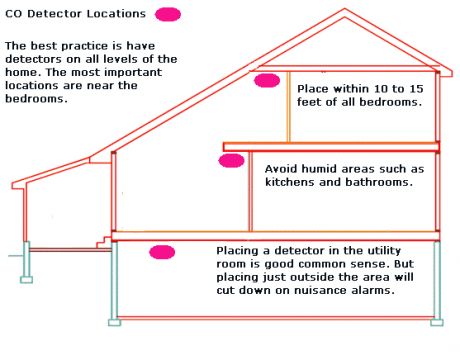

- Make sure you have a working CO and smoke detector near the sleeping areas of the home.

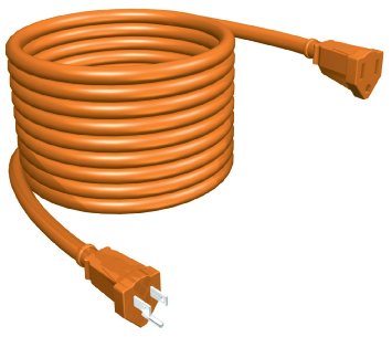

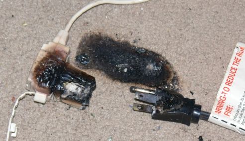

Lets not forget the electric space heaters and lamp cords. I caught one of my customers with a 1200-watt space heater running with a 16-gauge extension cord. I made them go buy a heavier cord.
- A 16-gauge extension cord that has any length will not carry the load of a 1200-watt heater. The cord will heat up and start a fire. Please use heavy duty 14-gauge or 12-gauge cords if you must use a space heater. Make sure you plug it into a receptacle where it fits tightly. If the socket feels loose, plug it in somewhere else till you get the receptacle replaced.

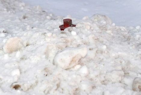

- In the event of a power outage, do not use your outdoor grille, or generator in the garage, and make sure fire hydrants are shoveled out.

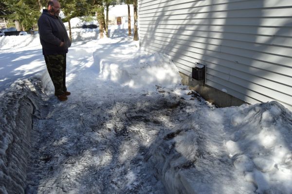

- And again, clear those sidewall vents. Here's one that wasn't. Note the soot on the ground. The family was in danger of carbon-monoxide poisoning. Their CO detector saved their lives.
