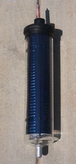

Q: Which type of thermal panel is better: Flat panel or evacuated tube type collectors?
A:The answer to this question depends on many factors specific to each installation. Here are some of the pros and cons to each type of panel:
Evacuated tubes
Pros: Evacuated tube technology is the newer and more technologically advanced type of solar thermal panel. Evacuated tube panels have been manufactured since the early 1980’s, but don’t date back as far as the flat panels. The vacuum created between the two layers of glass is a near-perfect insulator. It is beneficial to have a translucent insulator like air to ensure the most amount of sunlight is captured. Evacuated tubes have the best thermal efficiency throughout the year.
An evacuated tube array can easily be put on a roof by one installer. Each tube can be carried individually onto a roof. The assembly process allows for an array to be put together piece by piece instead of one single panel lift.
System overheating should be planned for when installing a solar array. During the peak summer months tubes can be removed if the panels are producing more hot water than is needed. Additionally, if one tube breaks the array can continue to function while waiting for a replacement.
Cons: A major concern is durability. Evacuated tubes have not been on the market nearly as long as flat panels. The downside of a tube made entirely of glass is the extra care needed for them to be transported and handled. A sharp shock or drop can ruin a row of tubes in an instant.
As the glass constantly expands and contracts depending on the heat conditions a rubber housing at the top must remain sealed to keep the vacuum between the layers of glass in the panel. The vacuum is used to lower the boiling point of the fluid inside the heat pipe. The lower boiling point causes the fluid to flash to steam. A concern is that years of ultraviolet radiation could reduce the ability of the rubber to keep its effectiveness. If any part of the rubber grommet leaks the vacuum is lost. When the vacuum is gone so is all the insulation. In addition, some styles of evacuated tubes have a vacuum on the copper heat pipe tube. This is another possible failure point in the panel. If either vacuum is lost the entire tube must be replaced. In the event of a leak or break in the tube it will fog up by releasing barium into the glass in some designs.

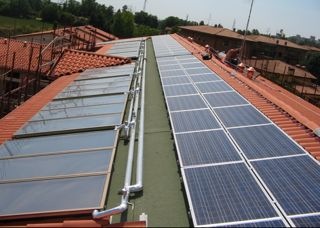

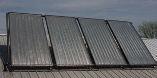

Flat Panel Collectors
Pros: This technology has been on roofs for over a hundred years. Clarence Kemp of Baltimore, Maryland is a founding father of solar water heating in the U.S. In 1891 he patented the first thermal collector. The flat panel technology has improved but the design is still simplistic. Flat panels are the gold standard in the industry. The design has stood the test of time and is in the fine-tuning stage of its product life.
Flat panels generally consist of copper tubing, insulation, and an enclosure. In the event of damage, a panel can be repaired easily by most contractors. Unlike an evacuated tube, a flat panel does not need to be replaced in the event of minor damage. Overall, flat panels are much more durable than tubes made entirely of glass.
Cons: Flat panels are not as effective in low ambient temperatures, or higher operating fluid temperatures. Some people don’t like the looks of a flat panel array as much as the evacuated tubes.
Flat panels can require more labor to mount. At least two people are needed to hoist a panel onto a roof. In some cases a crane truck can be useful to hoist an array of panels. Hiring a crane truck will speed up the process of hoisting an array and is safer than carrying panels up by hand, but it will add to the cost of the installation.

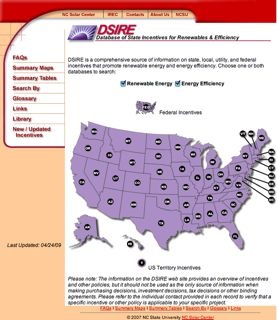

The best way to offset the amount of time for solar payback is to use all incentives available in the area of the installation. In some areas local, state and federal tax incentives are available. These incentives are worth the paperwork required to receive them. Information on federal, state and local incentives can be found HERE.

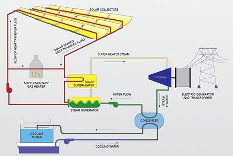

Q: Can solar thermal be used to generate electricity?
A: Yes. Nevada Solar 1 is an example of a solar thermal power plant. It uses parabolic mirrors in the shape of a trough to focus sunlight to piping containing solar transfer fluid. Other models use flat mirrors to focus the sun energy to a single tower from all angles. The heated fluid is used to convert the energy to steam. Steam spins a turbine, which generates electricity. Recent technology has allowed these plants to run during the night with stored energy to produce a steadier stream of electricity to communities. Technology is making this type of energy generation more consistent and efficient. Unfortunately, the temperatures are so extreme that this type of power generation is not currently practical for residential home use.
Technology in the solar field has improved the efficiency in which humans can harness sunlight. A thermal solar plant in the French Pyrenees can produce temperatures of 3,800 degrees Celsius by using mirrors to focus rays to a single focal point. Less than half the heat from the sun is lost during travel to Earth. Power Plants like this are incredible advancements in the ability to harness the sun.

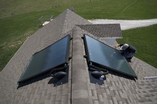

Q: What happens if I don’t have a south-facing roof to put panels on?
A: Panels can be mounted in many different ways. Arrays can be mounted on the ground separate from an existing building. Panels can be mounted vertically on walls. Collectors can mounted as an awning or canopy also.
Panels can also be mounted in various ways on a roof. The best-case scenario is to mount the panel facing directly solar south. Not all structures have good south facing surfaces. Panels can be mounted on the east and/or west side(s) of a roof. Some controllers can easily switch between east and west panels during the day to harvest the most amount of energy. Panels can also be mounted on the north side of a building using a reverse pitch bracket arrangement. With a reverse pitch bracket the panel points south from the north side of the building.

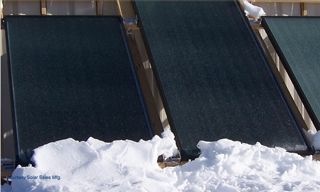

Q: What happens if snow collects on top of solar panels?
A: The best plan of action for panels in locations that get lots of snow is the angle of panel installation. Most panel manufactures recommend a panel angle of about 40 degrees from level. Panels at a steep enough angle will shed snow exponentially faster than a panel that is closer to level. Gravity is the easiest way to remove snow from a panel.
Additionally, panels should be mounted far enough above the roof or ground to allow the shed snow to collect below the surface of the panel. Without the room below snow will accumulate as if it had been shoveled there. It is often the case that a pile of snow like this will melt much slower than a single layer. Having a pile of snow touching the panel robs heat and blocks the collector surface area. White snow has a high albedo. This means it repels sunlight more like a mirror. Black surfaces like asphalt and solar panels have a low albedo and absorb a higher percentage of rays.

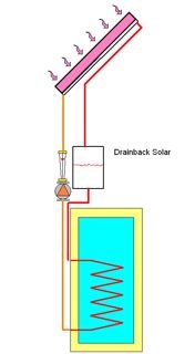

Q: How do I protect my panels from freezing?
A: Freeze protection is not needed in all locations. However, it only takes one freeze to ruin a solar panel. Two methods are commonly used:
A drainback system allows the panels to drain when the pump shuts off. The drainback method provides freeze protection as well as overheat protection. A drainback arrangement may require an additional tank for the water in the panels to drain back to. A drainback system requires more installation care to ensure the piping is sloped properly to the tank. Every inch of piping from the panel down must be properly sloped to ensure the water will gravity flow back down. An improper installation could result in a freeze break. Fewer components are needed to install a drainback system compared to a closed loop glycol system.
Pressurized glycol systems rely on a lower freezing point in the liquid to keep the panel and piping from freezing. To protect systems with glycol, yearly testing should be performed on the pH and freeze protection level of the fluid.
Equatorial locations may not need any freeze protection. However, even Florida freezes from time to time. It only takes one freeze to break a collector or other components. It is not worth ruining a solar panel or other component assuming it won’t freeze.
