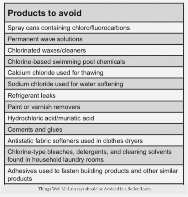

Look around to see if anything is stored in the boiler room, which should not be there. This could be things like paint or varnish remover, chlorine type bleaches or cleaners, spray cans, calcium chloride for snowmelt, or sodium chloride for a water softener. If they are, do your boiler a favor and remove them from the boiler room as they could interact with the flame and damage the boiler. Verify there is enough room to walk around the boiler. Most boilers require about 30 inches around it for proper service and combustion.
avoid in boiler room

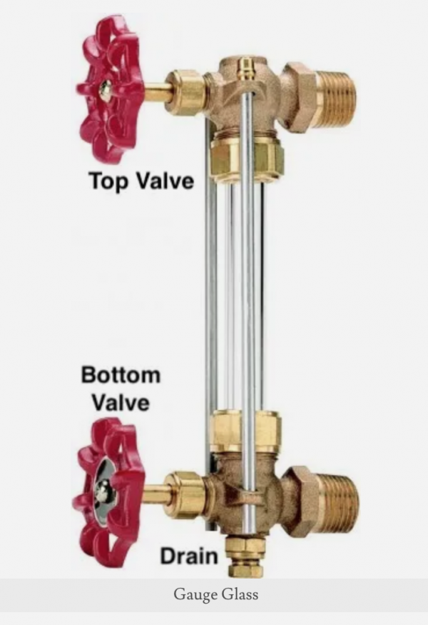

Is the gauge glass dirty? The gauge glass is the vertical tube on the front of the boiler that shows the water level inside the boiler. You should be able to see the water level inside the gauge glass unless you have flooded your boiler, as I suggested above. If the gauge glass is dirty, it can be removed and manually cleaned. It's a bit tricky and may not be something you would want to attempt yourself. Another way of cleaning the gauge glass, which does not require disassembly, is to use steam from your boiler. Close the steam valve on the boiler outlet, which goes to the steam piping. Start the boiler, and when the boiler reaches about 2 Psig, shut off the burner. Place plastic below the gauge glass to protect any electrical components.
gauge glass
Wear gloves and safety glasses because it will be hot. You can get third-degree burns in less than a second with steam. Close the valves directly above and below the vertical gauge glass tube. Open the drain at the bottom of the gauge glass. It looks like a small screw with sides where a crescent wrench can be placed. Loosen the screw until water starts to seep. When the water stops, open the top valve above the gauge glass. This will inject steam into the tube and should scrub the inside of the tube, cleaning it. The steam and hot water will shoot out the drain, so be sure you are not in the path of the hot mixture. After a few seconds, close the top valve, then the drain valve. Open the bottom valve directly below the vertical glass tube and reopen the top valve. There, you have steam cleaned the gauge glass.
