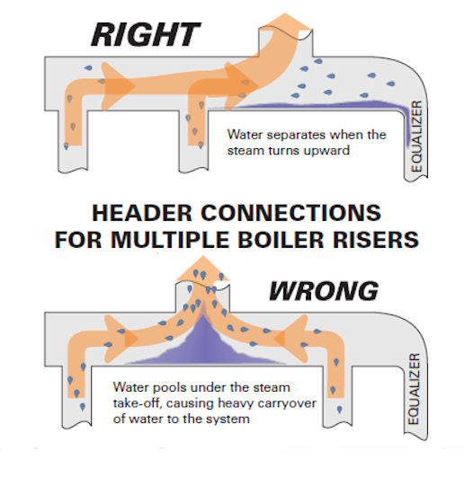

Steam boiler piping: The right way to pipe takeoffs from a header
