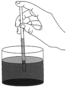

You know, it’s all about the atmosphere when you come right down to it. Put a straw into a glass of water. Hold you finger over the top of the straw. Lift the straw out of the glass. The water stays in the straw. How come? Because of the atmosphere, right?
We learned that when we were still little kids, didn’t we?
Put some water into a pipe. Hold your zone valve over the end of it. Close the other end with your F&T trap. Now, try to get the water to flow out. It won’t, will it? How come? Because of that darn atmosphere! It seems to be everywhere.
