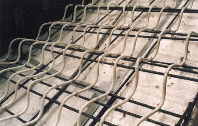

Steps are always a challenge. It is difficult to get the tubing in place, especially when it is cold out and the tubing is stiff. We try to get a loop (two passes) in the tread and a pass of tubing in the vertical riser. It is hard to get tubing close to the leading edge of the step where ice will accumulate. My friend and fellow columnist, John Abularrage came up with a brilliant innovation where he ran Multi-Cor PEX vertically down the steps and formed the bends such that the entire step was covered.
![snowmelt stairs multi cor pex](/assets/Uploads/_resampled/ResizedImageWzQwMCwyNTRd/snowmelt-stairs-multi-cor-pex.jpg)
This snowmelt innovation runs Multi-Cor PEX vertically down the steps and forms the bends such that the entire step is covered. Photo Credit: John Abularrage.
