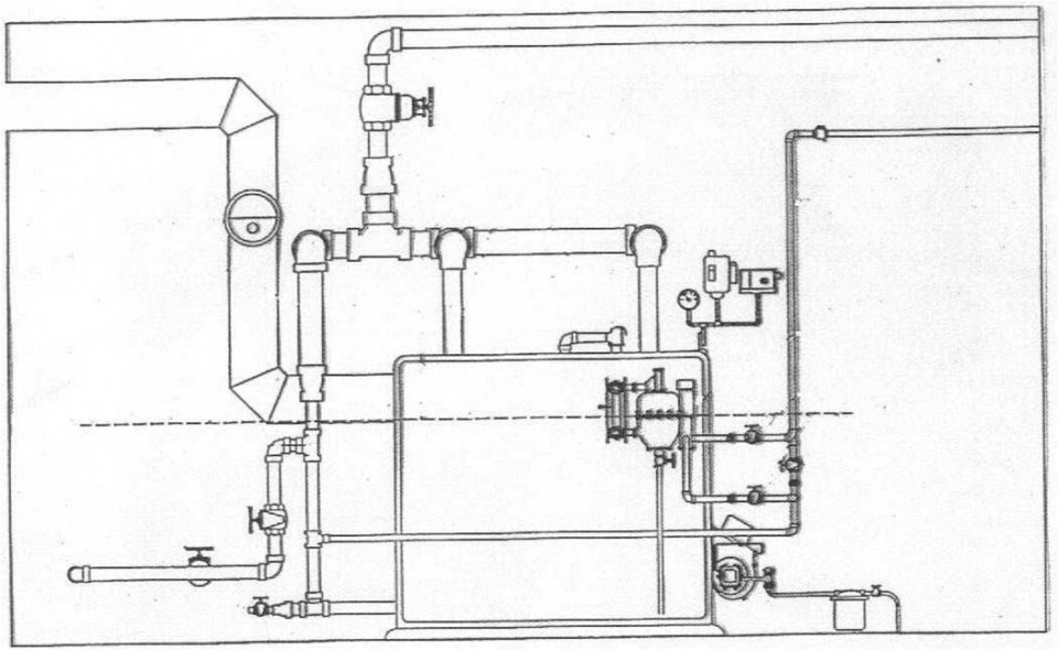

I’ve been looking at steam systems since 1970. I’ve read many books about them, and written a few myself. I notice nowadays that some boiler manufacturers are calling for the header to be a minimum of 24 inches above the boiler’s waterline. I don’t think that’s enough, and I think the Weil-McLain glass-piped boiler proves that it’s not enough. I think the bottom of the steam header should be a minimum of 24 inches above the top of the boiler jacket, and more than that, if possible. The higher the header, the drier the steam will be.
Pros who do steam know this. Many of them use a Dead Man trick called a drop header. This is where you bring your risers to a very high point, and then turn with your elbows first over and then down before entering your header from the top. You can learn more about drop-header piping HERE.
I wish the boiler people would get together and take another look at that dimension. It should be two feet at least above the top of the boiler, not above the waterline. It’s a fine point, but a very important one, and everyone will be better off if they made this change.

When you quote that next steam boiler-replacement job, suggest a king valve and a return valve to your client. A king valve goes on the pipe that leads from the header to the steam main. You’ll need more than one if you have more than one steam main leaving the header. The return valve goes (you guessed it) on the wet return, just before it meets the Hartford Loop. You’ll also put a full-port ball valve in the boiler’s mud leg.
