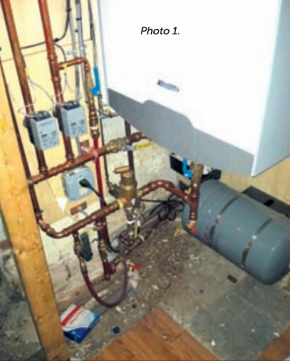

The client accepted my recommendation, and we installed a Triangle Tube Excellence condensing gas boiler with an integral DHW tank. This system was installed in a 1920s vintage D.C. row house with an English basement apartment. Space was tight in this basement apartment; the Excellence was chosen as it fit in the tight mechanical closet right off the kitchen (See Photo 1).

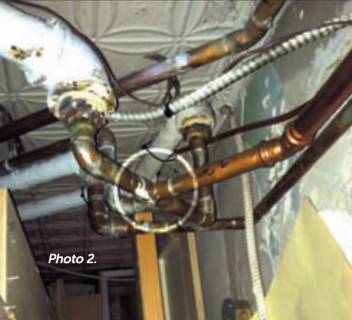

Another clue: Some of the piping was exposed in the basement. This was an old gravity system conversion, and the big 2-inch steel mains were accessible below some of the basement ceiling. The basement radiators were added later and piped with 3/4-inch copper. The main floor zone piping was cool at the boiler, yet the mains were very warm 10 feet away. This defied logic. What was going on?

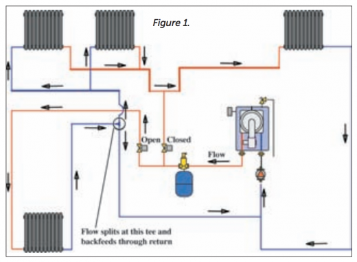

I traced out and marked all of the piping. As I was marking the returns from the main floor, I noticed that they were very hot. How could this be? I tracked the supply and return from a basement radiator. These were smoking hot, as this zone was still calling. The basement return teed into the returns from the main floor as indicated in Figure 1 and Photo 2. This tee was about 12 feet from the boiler.
When the flow reached this tee, it backfed through the tee and up through the main floor radiators. As these were piped with 2-inch black steel, there was very little resistance to flow. The tee tying the two supply mains together acted as a crossover, feeding the remaining radiators. Mystery solved. While this backflow was not much, it was enough to warm the radiators and overheat the space. We went back and cut in two check valves, eliminating the backflow and solving the problem. This backflow through the return main had existed since we installed the boiler but was only evident when the basement tenant cranked up the heat.
