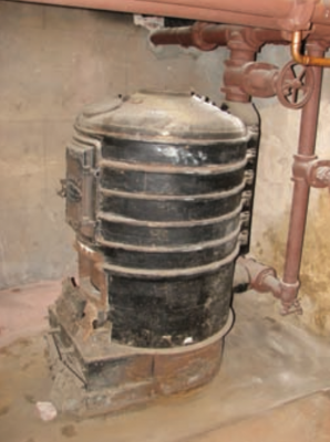

The original Gurney coal-fired boiler was still in place but valved off (see photo below). The heating contractor riveted a steel plate to the boiler. It read, simply, “Hubbard Heating Co. Washington, D.C.” The owner wanted to leave this boiler in place for historical value. I surveyed the heating system trying to figure out why two boiler blocks would fail in short order. This was an old gravity hot water system with massive cast iron radiators and large 3-inch and 4-inch steel mains. There was an old riveted steel expansion tank in the attic with the overfill pipe stubbed through the roof.

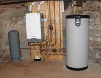

The replacement system consisted of a Triangle Tube Prestige condensing natural gas boiler. We also replaced an electric water heater with a Smart 80 stainless steel indirect fired DHW tank (see photo below). Because of the low head loss of the system, I piped the supply and return directly into the boiler without a low loss header or primary/secondary piping we would typically use with this type of boiler.
In this case, the goal was to maximize the combustion efficiency of the boiler by returning the lowest temperature return water back to the boiler. Flow is not an issue, due to the low pressure drop of the large mains and radiators. This is a perfect application for condensing boiler technology. These boilers operate most efficiently at low temperatures. This system operates on a reset curve with a maximum temperature of 160°F at design conditions.

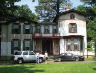

Civil War-era home
The second project was in an Italianate farmhouse built in 1860. The house is located in Thurmont, Md., about an hour north of the city, and is still in the same family as the original owner. The house was originally heated with fireplaces and had no central heat.

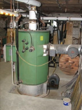

The current owner’s grandfather was a steamfitter and installed two steam systems in the 1940s. He installed two Kewanee steel oil-fired boilers connected to one-pipe steam systems (see photo below).

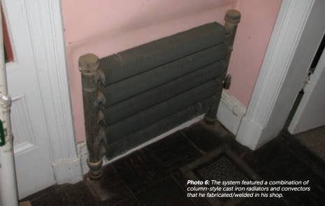

The system featured a combination of column-style cast iron radiators and convectors that he fabricated/welded in his shop.

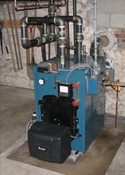

We did this job in two stages. We replaced the first boiler about 10 years ago using a Burnham V-8 cast iron oil boiler. We replaced the second boiler more recently employing a Burnham Mega Steam cast iron oil boiler.
The owner had both chimneys lined with stainless steel liners. We replaced all of the main vents, radiator vents, and a few of the valves that were broken. We ordered an optional header piping kit with the MegaSteam, which streamlined the piping process and minimized the amount of cutting and threading of black steel pipe. We ordered the boiler with an optional tankless coil to feed an aqua-booster tank in the winter. In the summer, the client closes a valve and uses the electric element in the tank for DHW.
