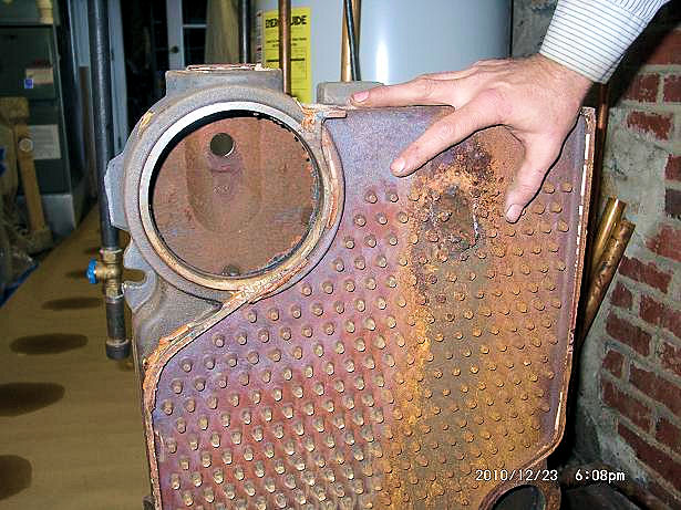

Years went by, and better steam boilers arrived – ones with wider sections, larger (and more) openings that allowed the steam to leave at a lower velocity, and bigger steam chests. But then, even some of these began to fail within a few years, and many from holes at the waterline.
I'd hear about the holes often on the Wall at HeatingHelp.com. Contractors and homeowners would say that the boiler was only a few years old, but now it had a hole in it, and right at the waterline. Some homeowners talked about more than one boiler suffering the same fate.
I went back to the old books and confirmed that a leading cause of this is often too much fresh water and the oxygen it brings along with it. Every steam system is an open system, and excessive oxygen will always cause iron to rust and eventually fail. If the piping system is leaking (and many old steam systems have buried returns), the automatic water feeder will do its job regularly, and that leads to holes at the waterline.
Hydrolevel introduced their VXT feeder, which has a water-meter function, to help with this problem, and it has helped, but some of those jobs I heard about had no leaks that anyone could find, and that had me wondering.
I was at a party not long ago when a rep from a boiler company sat next to me at the bar and told me that they had figured out what was causing the holes in the boilers on those systems that weren't taking on a lot of fresh water. This company had hired an independent lab to analyze the metal of boilers that had developed holes at the waterline. The problems were clustered in a geographical area, which made the company and the laboratory suspect that there was something in the water in that area that was causing the problem. It turned out to be high levels of chloride.
Now this is not chlorine, which some water companies use for treatment; this is chloride, or to put it more simply, salt. Chloride can come from the runoff after deicing trucks treat the roads during the winter, or it can come from natural sources. Once it gets into a boiler, though, it can cause problems, particularly if it comes in contact with abnormally hot surfaces..
Most of the boilers we use for steam heating nowadays have cast-iron sections with pins for efficient heat transfer from the flame to the water. These pins are also in the upper part of the boiler, up there where the steam disengages from the water. These boilers are also fired hard to get the most steam from a relatively small appliance. And that's where the problems start.
The combination of the chlorides in the water, and the very hot pins in the steam section of these modern boilers (it's too bad they have to be so hot), creates a condition known as "graphitic corrosion." You can Google that and learn more, but if you're not up for that, just know that graphitic corrosion eats cast iron. You wind up with holes at the waterline through which you could toss a tomcat.
The high temperature is the trigger that starts the corrosion process and those pins are as hot as they are because modern, vertical-flue pinned-section steam boilers are more efficient than the ones they replace. But if you look at the Dead Men boilers you'll notice that none of them had pins. They had smooth, ribbed surfaces and a lot more metal, and because of this, they weren't as sensitive to chlorides in the water.
Some manufacturers tried to solve this corrosion problem by using more sections for the same Btuh rating. This lowered the temperature of the pins in the steam section, but it also made the manufacturers who tried this less competitive. And as it turned out, it only prolonged the graphitic corrosion problems.
The chlorides are the problem, and the excessively high temperature on the pins is the trigger. The problems are widespread, occurring in the western and southern suburbs of Boston, the northern and northwestern suburbs of Providence, in New York State, on the eastern side of the Hudson River, from Albany to Peekskill, and in many areas of Long Island – all places with lots of steam heat.
So if you're using steam boilers of this type and you're having problems with corrosion, look to the water. Are you taking on a lot of feed water? The only way to know for sure is to meter it. Is the pH of the water between 7 and 9? The only way to tell is to test it and to monitor it.
Once you've checked those things, have the water tested for excessive amounts of chlorides. That could be the reason why the boilers you're installing aren't lasting. And this sort of internal corrosion isn't covered by most boiler manufacturers' warrantees, and neither is the labor involved in replacing these boilers once they fail.
