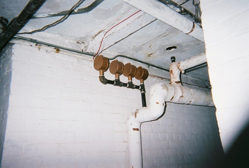

Can you see it in your mind’s eye? If you have a steam boiler that’s short-cycling and wasting fuel get the heck out of the boiler room and walk the length of the pipes. While you’re walking, whisper to yourself, “If I were air, could I get out?” Look for the main vents. Look for the steam traps on the radiators because before they can trap steam they need to vent air. Are those traps working? Look for float-and-thermostatic traps on the steam mains and steam-riser drips. Are those traps working? Did a hapless person double-trap those return lines? Double traps can keep the air from escaping the system because water will get caught between the two traps.
Wander and wonder. If you were air, could you get out? Answer that question and you’ll cure just about every short-cycling burner problem you’ll ever meet.
