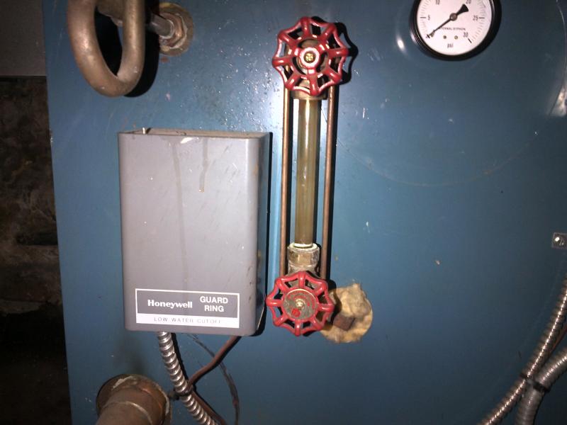

I was once on a problem steam job where the water seemed to vanish from the boiler as soon as the pressure hit its high limit and the burner shut off. There was an automatic water feeder on this job and it kicked in when the water plunged out of the gauge glass. It added some water to the boiler, of course, and that raised the water level. Then the burner restarted.
A few minutes later, the pressuretrol sensed the high limit again and shut off the burner. Once again, the water vanished from the gauge glass and the feeder added even more water.
Before long, the boiler was flooded. And once the water level got near the top of the boiler, the steam started sucking great gobs of water into the system piping. That's when the fun started. The water flew down the mains and hammered like mad. The boiler went off on low water again. The feeder fed again.
This job was becoming a nightmare for the installer. Before I had gotten there, he had piped a check valve into the wet return. He figured that the water was backing out of the boiler, but the check valve didn't make a bit of difference because the water wasn't backing out of the boiler. It was rocking between the boiler and the gauge glass. But he couldn't see that from the outside. He eventually removed the check valve and called me.

Now here's the key to the vanishing water problem. The formation of the steam in a too-narrow section can make the water inside the boiler rise up. The water in the boiler gauge glass, however, has no steam rising up through it. This water is a bit heavier than the steam-laden water inside the boiler, so it drops a bit to compensate for the difference in weight. What you're seeing in the gauge glass is actually a false water line. It's not representative of what's actually happening inside the boiler.
Now imagine what happens when the steam pressure reaches the high-limit setting of the pressuretrol. Suddenly, the burner shuts off and removes the heat needed to produce steam. The steam bubbles in the boiler water immediately begin collapsing, just as they do in a pot that's boiling over when you remove it from the stove. As the bubbles collapse inside the boiler, the water level plummets. The water in the gauge glass, which is denser (heavier) than the water in the boiler falls into the boiler to compensate for the falling boiler waterline.
It's like a scale that's trying to find a balance point, but from the outside, all you're seeing is one half of that scale. You're seeing the water momentarily vanish into the boiler when the burner shuts off on high limit. And if there's a feeder, you hear it click on. Before long, the boiler is flooded.
