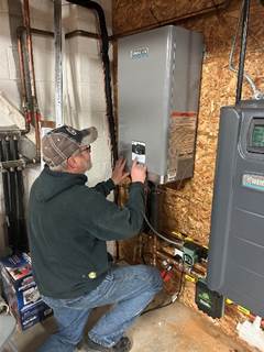

The chosen solution featured a Weil-McLain ECO Hybrid System, which included an outdoor air-to-water heat pump and a compact indoor wall-mounted unit, both designed to work with the existing high-efficiency modulating propane boiler.
The ECO HP is designed to integrate seamlessly with Weil-McLain's high-efficiency condensing boilers. By combining a durable, inverter-driven outdoor heat pump with a compact indoor unit, the system intelligently shares the heating load – maximizing energy efficiency and minimizing fuel consumption. It features an intuitive user interface, integrated staging control capabilities and compatibility with indirect water heaters. Ideal for residential applications using radiant floor heating or low-temperature hydronic systems, the ECO HP delivers quiet operation, long-term reliability and measurable reductions in energy costs. In this case, the outdoor unit was mounted on a stand to prevent snow accumulation and ensure proper drainage – an important consideration in Lake Michigan’s lake-effect climate.
As a bonus for the home's domestic hot water needs, an indirect tank was integrated into the system, while a dedicated heat exchanger handled the snow melt functionality for exterior surfaces. Heating throughout the residence was divided into six zones, each managed through a centralized zone control panel for efficient distribution.
Smooth Installation and Reliable Performance
According to Downs, the installation was straightforward and similar to setting up a conventional central air system. “The indoor unit was lightweight and compact – easy to mount with standard tools,” he said. “The outdoor unit connected via flare fittings, and the line set was within the range for the unit’s pre-charge, so everything aligned perfectly.”
The 120V indoor unit and 240V outdoor unit required standard connections. Controls were intuitive, and the system relied on Weil-McLain’s guidelines to set compressor runtime limits and optimize switchover from the heat pump to the boiler. Downs noted that while the system was new, the manual was easy to follow. “If you're already doing mini-splits and hydronics, this is very manageable,” he said. The installer also credited Weil-McLain’s ECO Calc Application Sizing Tool, which guided setup of system parameters and switchover logic.
