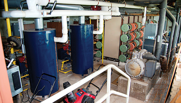

According to John F. Porcella, chief boiler inspector of West Virginia, and other boiler inspectors, flammable items are often stored inside a boiler room and this is problematic. It is not uncommon to find lawn mowers, paper towels, cleaning solvents, dust mops, snow blowers and cans of gasoline stored inside the boiler room.
A school in our area stored student records in cardboard boxes next to the boilers and school officials were surprised when the records caught on fire.
Another danger inside a boiler room is when the combustion air openings are blocked or restricted.
