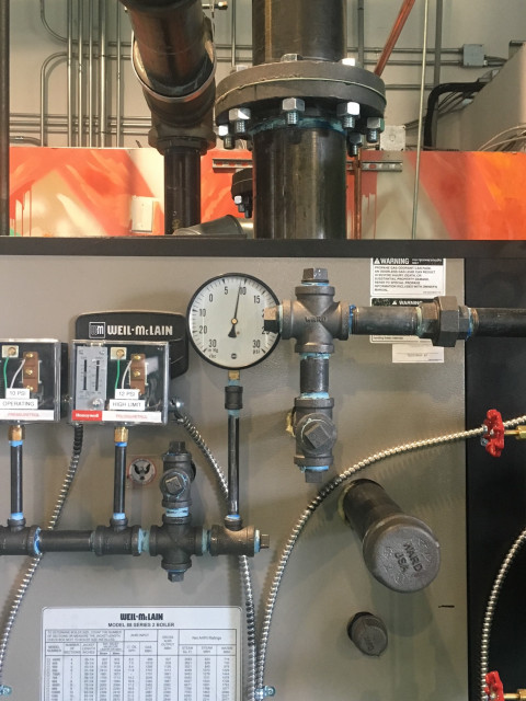

Backmann chose David LaBar, owner of DL Mechanical of Port Reading, N.J., to specify the boiler model and handle the installation of the new steam system. After reviewing the design parameters, LaBar recommended installation of a Weil-McLain 88-Series cast iron low pressure steam boiler – a durable unit that offers ease of maintenance, thermal efficiencies up to 85.7% and is ideal for single or multiple unit systems.
“The boil kettle required about 550,000 BTUs, but we wanted to exceed the heating load requirements to give us some room for future growth,” said LaBar. “The 88 Series boiler is rated at 1,050,000 BTUs.”
LaBar also specified a power plant with gas burner as part of the system.

To add efficiencies to the system, LaBar designed it to feature two five inch steam risers from the boiler into a six inch drop header to provide the dry steam. This design ensures the steam used in the process is extremely dry.
“The dryer the steam, the more efficient the system,” said LaBar.
Once the kettle condenses the steam, it releases the condensate via float & thermostatic (F&T) steam drip traps to a condensate receiver and pump that moves the condensate to a boiler feed pump. The boiler feed pump returns the condensate to the boiler when the water level falls low enough.
A total of seven F&T traps were used, three on the boil kettle, one on the hot liquor tank, one at the end of the steam main drip, one on the kettle riser drip, and one on the hot liquor tank riser drip.

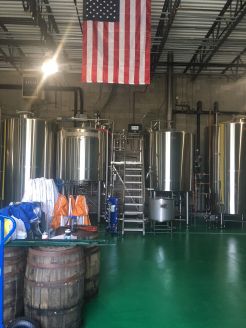

breweryWith installation complete, brewery owners brought in inspectors to approve the work so the manufacturing process could begin.
“The plumbing inspector that examined the system thought the installation was really well done,” said Backmann.
The Cypress Brewing operation is now in full swing with the production process from start to ready-to-drink brews taking about 28 days on average.
The entire process is automated through a computer that manages the temperatures and the solenoid valves which control the steam entering the coils. Backmann reported that one major benefit of the new process is there is less charring of the beer.
“Before with the lighter beers we sometimes tasted a slight burnt flavor in the background because the electric element came in direct contact with the beer,” said Backmann. “Now that the vessel itself is jacketed there is a much better dispersion of the heat. Everything is very balanced and heats from the bottom all of the way to the top.”
