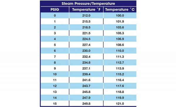

steam pressure vs temperature

Steam pressure. One of the common issues with a brewery boiler is the setting of the steam pressure control. If the steam pressure is too low, the brewer cannot get the rolling boil they need for the process. If the pressure is too high, the relief valve can open and lose all the steam also affecting the brew process or the limit control will trip requiring a manual reset. Most brewers adjust the pressure setting between 12 to 14.5 pounds pressure. This is very close to the relief valve and limit pressure control setting.
Relief valves. Low pressure steam boilers have a relief valve setting of 15 Psig. Many relief valve manufacturers do not want the boiler operated at the setting of their relief valve. For example, the installation instructions for a Conbraco Model 12-14 relief valve states, The minimum required pressure margin for this type of valve is 4 PSI. UNDER NO CIRCUMSTANCES SHOULD THIS MARGIN BE LESS THAN 4 PSI!
This means the boiler setting should be no higher than 11 psi. If the boiler is operated at the setting of the relief valve, it may open and lose all the steam and water from the boiler. The discharge of the relief valve should include a drip pan well that will limit the weight on the relief valve and allow the drainage of any water in the discharge pipe of the relief valve.
