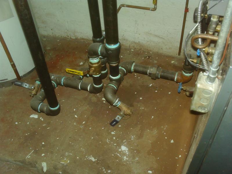

mudleg drain

  2. If it's not already there, I'll pipe in a boiler drain and ball valve on each leg of the wet return. This allows me to flush the line and direct the mess through a garden hose to a safe place outside the building. The cost of the few fittings is worth it. It shows customers that you care about their system and keeping their home clean. On new boiler installations, I install the boiler drains and valves as part of the installation.

  4. A lot of speedy dry, a good vinyl tarp and a wet vac do the trick. Even better, change those old drain valves to full-port ball valves and give it a good flush.

  6. Attach a garden hose at a hose cock to an outside drain.
