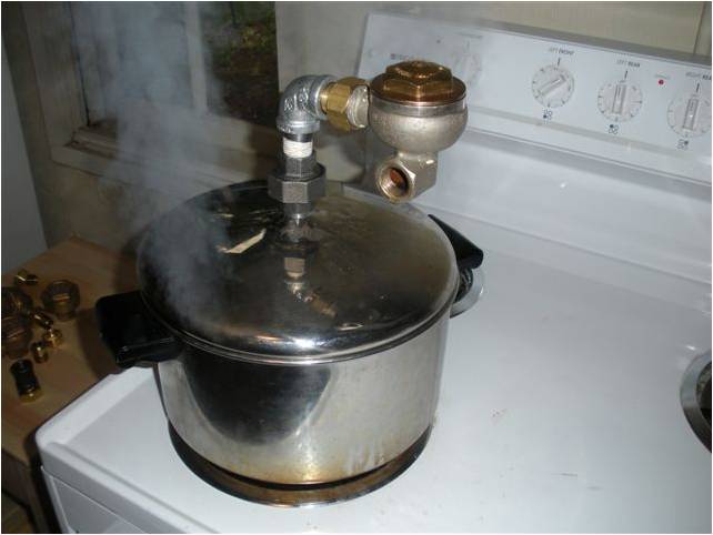

With the exception of some of the older vapor systems, thermostatic radiator traps belong on all two-pipe steam radiators. They go down low, on the side opposite the radiator’s supply valve. These wonderful automatic valves will respond to temperature, which is great because, within the radiator, steam is hotter than the condensate that forms when the steam turns back to water. That’s what opens and closes a thermostatic trap.
They’re normally open and air will pass through them ahead of the steam and vent from the system somewhere downstream. When steam arrives, the thermostatic element will expand because it’s partially filled with alcohol and under a vacuum. Alcohol boils at a temperature that’s lower than the temperature at which water boils. When the element expands, it pushes the pin into the seat and traps the steam inside the radiator.
Condensate builds up and flows into the trap. At this point, we need a drop in temperature of about 10-15° Fahrenheit before the trap will reopen. When it does reopen, the differential pressure across the trap will move the condensate from the radiator into the return so it can make its way back to the boiler.
Thermostatic radiator traps nearly always fail in the open position because this is the position that will cause you the most grief. But because they are sensitive to temperature, you can check a thermostatic radiator trap with a thermometer. Go ahead; take its temp on one side and then the other. You’re looking for that 10-15° difference, and you’ll need to keep in mind that this temperature is relative to the steam pressure. Steam at 1-psi pressure is about 216°, so on a low-pressure, space-heating system, the traps will open when the condensate is somewhere between 200° and 205° F. That’s nice.
However, if you’re a running, say, 10-psi pressure on that space-heating system because you happen to be a knucklehead, the steam temperature will be 240° F. and the trap will vomit condensate at about 225° into the return lines, where some of it will immediately flash back into steam, defeating the purpose of the trap altogether.
If you’d like to have more fun that a laser thermometer can provide, you can make yourself a trap-testing station out of a pot. Seriously. Just look at the photo up above. Isn't that delicious? It works like a charm and speaks well for American ingenuity.
