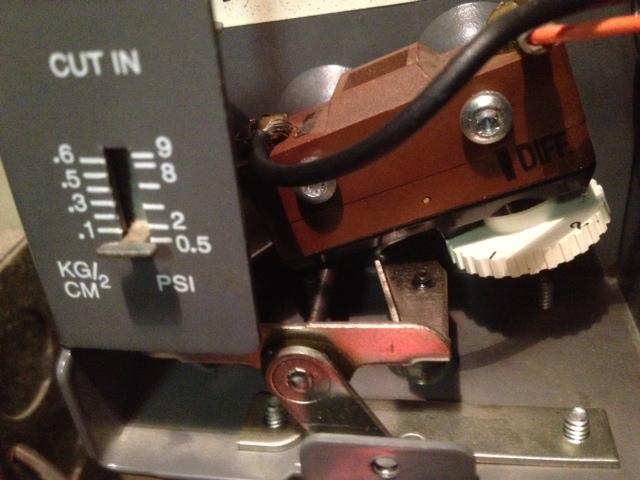

One of the things I had to get through my thick skull when I was young and learning about steam heat was that raising the pressuretrol setting wasn't going to get the building hotter any faster. Cranking up that control is, of course, the normal reaction of most troubleshooters when faced with uneven heat. The steam doesn't want to go upstairs? Oh, I'll get it to go upstairs! And then out comes the ol' screwdriver, which knows but one way to turn. That being clockwise.
What I learned along the way, though, was that when you raise the pressure on your steam boiler, the steam doesn't go faster; it goes slower.

Think about it. If the amount of steam the boiler produces in one hour is fixed (which it is). And if the pipes will always have the same amount of internal space (which they will). And if that steam takes up more space when it's at low pressure than it occupies when it's at high pressure (which it does!). Then we can say with absolute certainty that our given amount of steam, over the course of that one hour, within those pipes of a fixed size will definitely move faster at low pressure than at high pressure. It has to. The steam is as big as a school bus at low pressure. And it's turbocharged.
The Dead Men who designed those old steam systems knew this. They designed their pipes to deliver steam to your radiators at very low pressure. The lower the pressure, the faster the steam will travel. If the steam isn't getting to the radiators, it's not because of a lack of steam pressure; it's probably because the air vents aren't working, or they're in the wrong place. Replace or relocate them.
And crank down that pressuretrol.
