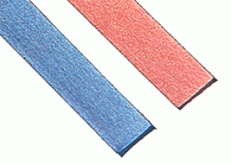

What’s the cheapest tool you can carry if your business includes taming old steam-heating systems and making them purr with greater efficiency?
Litmus paper!

So use that cheap tool. Keep some litmus paper in your toolbox and check the pH whenever you blow down a low-water cutoff. It’s a simple test and easy to do, and by getting the water’s pH just right, you can solve a lot of problems that are costing money.
