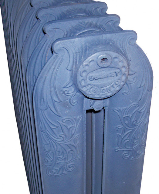

A guy called me to ask if I had any output ratings for some oddball steam radiators he needed to measure before he could replace the boiler. I looked them up and told him. He thanked me and hung up, but then called back about an hour later.
“I’m sorry to keep bugging you,” he said, “but this doesn’t make sense.”
“What doesn’t make sense?”
“Well, when I add up all the radiation in the building and then figure in the pick-up load for the piping, I’m coming up with a total EDR that exceeds the rating of the boiler that’s here by about thirty percent.”
“Are you sure you measured all the radiation correctly?” I asked.
“I went by the numbers you gave me for the oddball radiators, and I already had the ratings for the rest. Yes, I’m sure that the numbers are right.”
“What did you use for your pick-up factor?" I asked.
“I allowed the standard 1.33,” he said. “All the original radiation is still here. I don’t see any capped risers anywhere.”
“Are the pipes insulated?”
“Yes.”
“Then size your replacement boiler by the load you calculated,” I advised him.
“But the old boiler is nearly a third smaller than the one I’m figuring. And it’s been heating this place for years,” he went on. “It’s going to be tough explaining to the owner that I now have to put in a bigger boiler. How am I going to justify it?”
