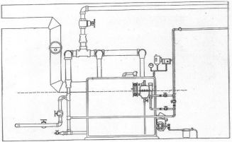

The importance of the Piping Around the Boiler
As boilers became smaller, the piping around them became more and more important. Today's replacement steam boiler contains much less water than the boilers of yesteryear. And yet the new boiler produces just as much steam as the old boiler! Modern oil burners and improved boiler design make this possible. But if you want that job to be successful you have to pay careful attention to the boiler manufacturer's near-boiler piping specifications. Ignore them at your own risk!
The purpose of the piping specification is to give you a boiler that delivers dry steam. Dry steam contains a great deal of latent heat. If you add even a little moisture to the steam by piping the boiler incorrectly (and letting the water leave the boiler with the steam),the latent heat content of the steam will suffer. The steam, in essence, will condense in the moisture before it has a chance to reach the radiators. In short, the steam will lose the "race" to that last radiator and parts of the building will be cold.
And not only will the building heat unevenly, the fuel consumption will also increase because the pressuretrol will never reach its high limit. And to make things worse, you'll probably also have water hammer.That’s the knocking in the pipes that people who don’t know any better think of as normal. Follow the boiler manufacturer's instructions to the letter and you’ll avoid most of the common problems associated with steam. Here are a few of the things the boiler manufacturers will tell you to do:
  • Allow at least 24 inches between the top of the boiler and the bottom of the steam header.
  • Use full-size risers to the header.
  • Pipe the system take-offs at a point between the last riser to the header and the equalizer.
  • Pipe the swing joints into the header. Use a reducing elbow to connect the header to the equalizer.

The boiler manufacturer determines the size of the equalizer. Its job is to return any water that slips out of the boiler with the steam, and also to balance the pressure between the supply and the return sides of the boiler. Without a properly sized equalizer, water can back out of the boiler.
Never pipe a steam take-off over the equalizer. The steam's velocity can create a pressure drop in the equalizer that will lift the water up, causing a corresponding drop in the boiler's water line.
In 1919, the Hartford Steam Boiler Insurance and Inspection Company invented the Hartford Loop. Its job was to prevent water from leaving the boiler, should a return line spring a leak. Here's more about the Hartford Loop.
The connection between the loop and the equalizer must be made with a close nipple to prevent water hammer. This is because steam is forming in the Loop connection. Returning condensate can cause this steam to rapidly condense and shrink to 1/1700th its steam volume. The water rushes into fill the void. As the condensate slams against the back of the tee,you wind up with water hammer in the return.
The dimension labeled "A" in the diagram represents the distance you have to maintain between the center of the gauge glass and the bottom of the lowest dry return in the system. In one-pipe systems that have DOE Heating Capacities greater than 100,000 BTUs, "Dimension A" must not be less than 28 inches.Steam A Dimension Dry Return
"Dimension A" provides the force that puts the condensate back in the boiler.Without it, water will back up into the horizontal piping and shut off the take-offs to the radiators. The house will heat very slowly (if at all), and certainly very unevenly. You'll probably also have water hammer.
And this is also why you don't see main vents on many of jobs. They're installed improperly and get damaged on the first few cycles. That's a shame because main vents are the key to good one-pipe steam operation. If you're using good main vents near the ends of every main, steam will travel very quickly to every radiator in the building. Vent large radiators quickly and small radiators slowly no matter where they are in the building. Focus on the air content of the radiator rather than its location in the building.If your main vents are working, steam will arrive at each radiator at about the same time.
