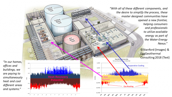

The variations of opportunities to exchange energy between Building Systems, especially in mixed-use communities are staggering. Stanford University provided some evidence of this when they retrofitted their campus and proved the amount of thermal advantage load sharing that could be accomplished by sharing energy between heating and cooling systems there.
Stanfords Thermal Advantage

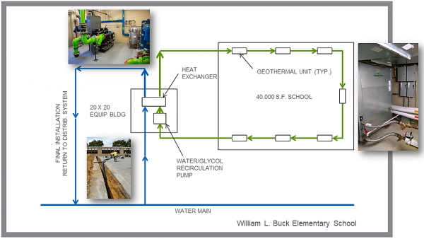

A nearly untapped Frontier involves the energy coming into and out of our communities. I'm talking about potable water, and wastewater. Just considering wastewater, US Department of Energy estimates that 350 billion kilowatt-hours per year of energy paid for by its citizens goes down the drain. And potable drinking water represents a remarkably simple heat exchange means for buildings of all types. Just take a look at this prototype project conducted in Valley Stream, New York:
Valley Stream Elementary
American Water Works Company, Inc., or “American Water”, working with the New York Department of Public Service (DPS) in 2015 installed a water-main sourced system for the William L. Buck Elementary School in Valley Stream, N.Y. As can be seen in the image, the water main was used as a heat transfer medium to feed the school’s newly installed geothermal heat pumps (GHPs). Oak Ridge National Laboratories was tasked with studying the impact, and in June 2018 produced the report, “Evaluation of the Impacts of Heat Exchanger Operation on Quality of Water Used as Heat Source and Sink”. I invite you to read the executive summary yourself, but the key statement quoted from the report is, “Review of the data identified no conditions that would prevent the use of heat exchange outflow water for water supply”.
It’s remarkable to note that properly applied, existing infrastructure, such as potable water mains could be used for heat exchange for buildings in the very near future. It's equally important and remarkable to note that now more than ever, our tradespeople must be properly educated. Apprenticeship programs such as those run by the Plumbers and Steamfitters Local 7 in New York help us to ensure that our workforce is properly trained. Increasingly, communities will begin integrating existing infrastructure to provide “Thermal Advantage” opportunities.
