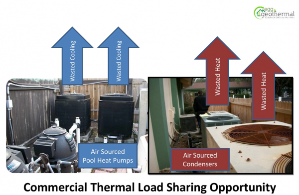

Air source heat pumps designed for pool heating use outside air, pumping heat out of the ambient air into your pool or hot water tank. However, they too rely somewhat on cooperative weather conditions, that is; air temperatures being warm enough to facilitate efficient extraction of heat to transfer to potable water and/or pool heating needs. Air source heat pump efficiencies are in the 3.0 COP ranges (300% efficient).
pool with ghp

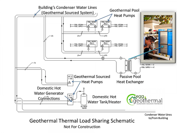

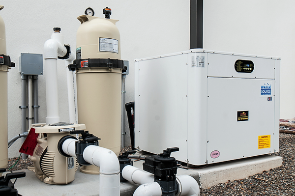

Water source equipment provides the only reasonable way to capture waste heat. The rejected heat from a water sourced heat pump may easily be made available to other systems in need of heating BTUs, especially a swimming pool. This can be accomplished passively through an exchanger, or actively through a pool heat pump.
geothermal thermal load sharing schematic heating pool
Passive Pool Heating
As viewed in the schematic, the condensor water may be run through an exchanger installed in the pool-water circuit, allowing the pool water to pick-up the heat being rejected from the home or business (such as a resort or hotel with a pool). The process serves to provide passive heating of the pool, and increases the efficiency of the water-source heat pumps or chillers.

For active heating of swimming pool and spa the best scenario is attained with a geothermal, or “water-to-water” heat pumps, pulling heat from a dependable, renewable energy source; the earth. Geothermal heat pumps can be about 5.0 COP (500% efficient). When tied in to a common condensor water loop, efficiency can go up.

While your customer is paying for electricity to power their HVAC cooling system, they are also providing for the energy to run computers, lighting, blow dryers, ovens, and domestic water heating. The HVAC system uses power to remove the heat created by all of these internal gains on top of the occupant loads. They are actually paying for energy twice to remove this waste heat through the process of cooling their house. When the energy is transferred to a pool, spa, or domestic hot water (DHW) system, the removal of heat from the building for HVAC provides real work that may be put to good use.
Whether the heat pumps and chillers are on a geothermal loop or a cooling tower, the benefits a customer receives from a water sourced system include the ability to channel and use this waste heat energy. The heat is entrained in the discharge water line. Most manufacturers of geothermal heat pumps even have a factory installed hot water generator available. This option gives you two extra connections labeled DHW (Domestic Hot Water) “In” and “Out” that may be connected to most any hot water tank, and the geothermal heat pump can turn waste heat into usable hot water.
There are thousands of geothermal heated pools around in the US. There is a good chance that the local YMCA, hotel, health club or community pool near you already has geothermal sourced pool heating. Surprisingly, many of these still have air sourced cooling systems that could be converted to water sourced geothermal during the normal course of HVAC equipment attrition and upgrade (another opportunity for income for plumbing and heating contractors!).
